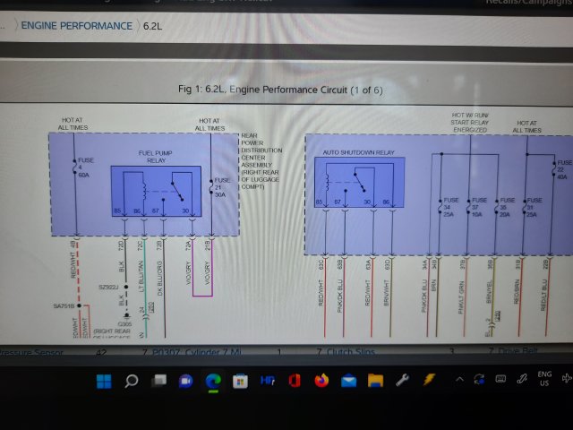

Anyone have access to wiring info?

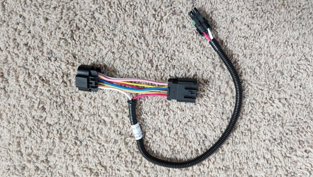

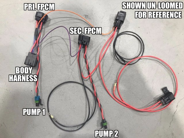

The problem is there's something funny with the way the dual pump drop in systems are wired to the second FPCM that is causing my pumps to run non stop after the car is keyed to "run". It should just prime and stop. Keying the car back "off" the pumps and JMS still keep running. JMS support has been good to work with but claim this is a known issue and they don't have a solution at present. Somehow Jon and Jim got it to work in his car, but even JMS has no idea how that's possible.
SO, I've been looking at re-wiring the JMS pigtail on the second FPCM to see if I can resolve the issue. Looking at the Y harness going from FPCM 1 to FPCM 2 on this drop in fuel system it's super simple only using a relay and a "signal" to keep the two fuel pumps in sync voltage wise. The JMS pigtail is setup for a Redeye or Demon that has two factory FPCM harnesses. My thinking is to remove some of the pins in the JMS connector on FPCM 2 so that it only has what the drop in system has connected.
I was hoping maybe the JMS pigtail was wired to get +12V source from something other than the fuel pump relay and I could simply move that wire to the proper pin in the connector, but best I can tell it is actually getting input from the fuel pump relay, so it's something else making the pumps and JMS continue to get voltage after key off. It's back feeding somehow.

I haven't tried unplugging the relay directly but any break in power to the JMS shuts it all down. JMS gets power from both FPCM modules through a simple 2 pin connection, +12V in then sends that out as an increased voltage you specify to the pump. Unplugging either of those shuts everything off.
One of these plugs directly in to each FPCM then the 2 pin white/red connectors go to the JMS box. Red is +12V and White is output to pumps. As you can see everything else is straight pass through form harness to FPCM.
Right now I just have the JMS connected to one FPCM and it's working fine but only on the one pump. Putting it on both will be better as I can give each pump a little voltage instead of all the increase on just one.

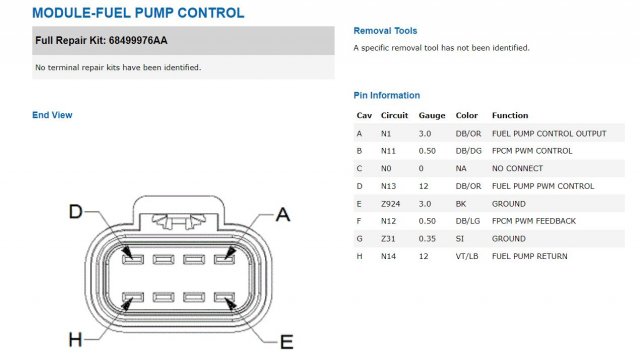

Looking at the dual pump harness:
FPCM 1 connector has this configuration:
PIN A +12V from fuel pump relay output as described in the wiring diagram. The external relay for the dual pump system is also activated from here.
PIN B goes to PIN B on FPCM 2 connector. This is the PWM Control and makes sense to keep both pumps in sync with the variable voltage they see. This wire is purple.
PIN C NO CONNECTION
PIN D I believe this is the +12V out to fuel pump 1
PIN E Ground
PIN F PWM feedback this wire is blue. This also makes sense as this is the feedback loop back to the PCM telling it the commanded voltage is being seen.
PIN G NO CONNECTION
PIN H This is another connection to fuel pump 1, the wire is black so likely the fuel pump ground or this is used to complete the pump circuit.
FPCM 2 connector is super basic and has the following configuration:
PIN A +12V from external relay shown in the harness above.
PIN B Purple wire from FPCM 1 and used to keep the pumps in sync I believe.
PIN C NO CONNECTION
PIN D fuel pump 2 +12V
PIN E Ground
PIN F NO CONNECTION
PIN G NO CONNECTION
PIN H another connection to fuel pump 2, the wire is black so likely the fuel pump ground or this is used to complete the circuit.
So there's several things not connected to FPCM 2 on the dual drop in harness, but the JMS has everything wired in theirs. I'm going to try removing the wires on each JMS harness that have no connection and test.
If that doesn't find the problem then it'll have to be something internal to the JMS control box and I'll have to add a relay or diode somewhere.
