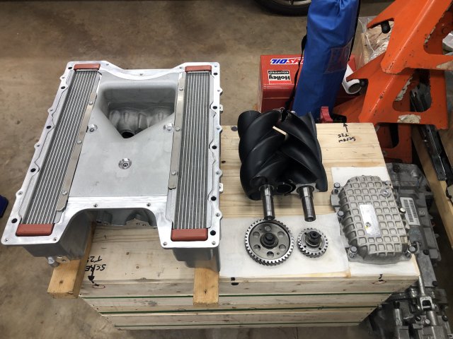

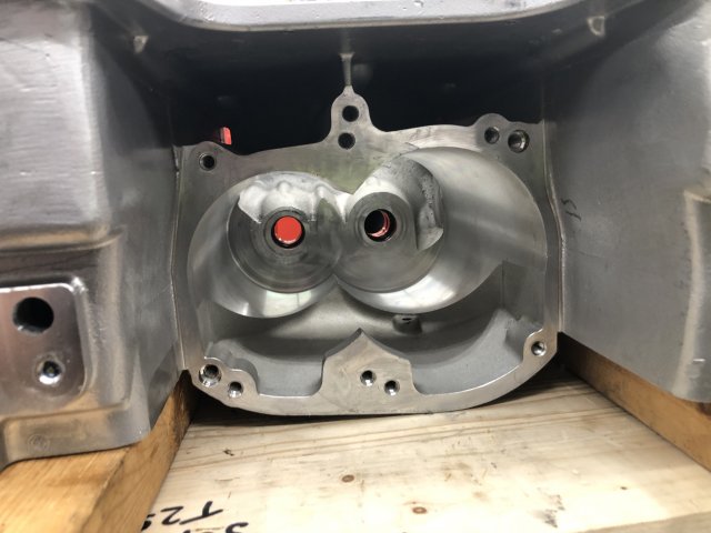

Have my First blower apart now to fix it, gear side of drive rotor galled into the back of the case because bearing bore was too tight to allow it to expand forward in the plate, it couldn’t because it was too tight. I didn’t know this until after the damage was done. Started car up, sounded perfect, let it warm up 10 minutes all still good, stabbed it a few times, very responsive, held it at 2500-3000 rpms, 20 seconds in engine just shut off, no noise no nothing, took SC belt off couldn’t turn the SC, removed kid saw galling on back of rotor case. Removed plate, honed bores to match OEM plate and put it on a spare blower I recently purchased (yea, I’m a dare devil lol) second time around all seems well still but FAS not helping one bit unfortunately, guys a crook in my book. 57766EAE-D677-4C2A-A8EA-D219367A5875.jpeg 5513ABE7-38B5-49E2-8045-5AB617AC6331.jpeg A0A4B0C0-FC19-4E28-8E1E-41031F81EAA8.jpeg E12AF88F-E062-46D4-B75F-1A8AAD980F14.jpeg E905831C-EEAF-4AB2-B3CC-77A828398B26.jpeg

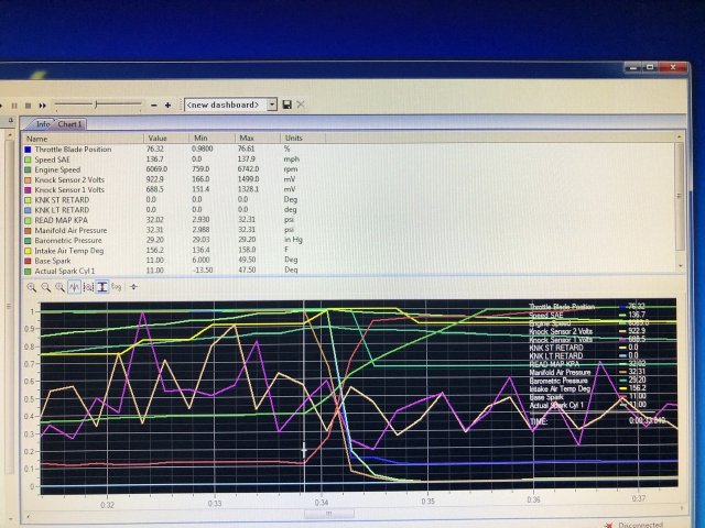

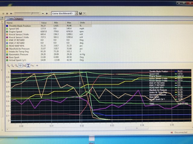

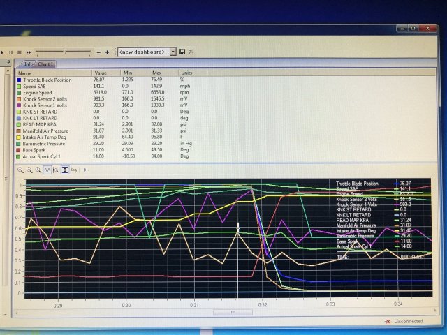

@Speedy! I added some spark data, this what you where looking for?
3,808
9,019
@Speedy!

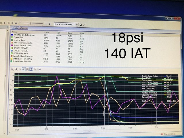

Here’s spark data with hot IAT’s , this 1/4 only netted 130.4 mph, look at the spark allowed only, 11 degrees
Next run with intercoolers and lower IAT’s had 14 degrees of spark and 134.5 mph 1/4.

Dang too bad about FAS we've learned over the years to be careful on HEMI vendors right @Linda's Hell Cat
Yep you're a sharp guy and added the right pic. That's your timing advance. There's another pic called IAT Advance that will show how much is being removed.

@Speedy!
What info helped? The screen shot from HPT or data graphs in DiabloSport?
I assume look in HPT for the IAT ADVANCE chart??

Have my First blower apart now to fix it, gear side of drive rotor galled into the back of the case because bearing bore was too tight to allow it to expand forward in the plate, it couldn’t because it was too tight. I didn’t know this until after the damage was done. Started car up, sounded perfect, let it warm up 10 minutes all still good, stabbed it a few times, very responsive, held it at 2500-3000 rpms, 20 seconds in engine just shut off, no noise no nothing, took SC belt off couldn’t turn the SC, removed kid saw galling on back of rotor case. Removed plate, honed bores to match OEM plate and put it on a spare blower I recently purchased (yea, I’m a dare devil lol) second time around all seems well still but FAS not helping one bit unfortunately, guys a crook in my book. View attachment 15192 View attachment 15193 View attachment 15194 View attachment 15195 View attachment 15196
I hear there’s another plate in development by another shop that won’t have these issues and a superior finish as well, and cost less too!!
That totally sucks. Sorry you're going through that after all the trouble, expense, and work to improve it. I'm not really sure what your doing here though. Are you cutting down the lobes(lengthwise) to fit better in the case with the old FAS plate or are you turning down the bearing journals cause theirs are too tight? I thought FAS just ported the stock plate but I guess they use there own and make it too tight. It's also completely mind blowing that .003 stopped the blower dead in it's tracks. I would think it would just keep galling and tear out metal till self destruction, with the power of the engine turning it.

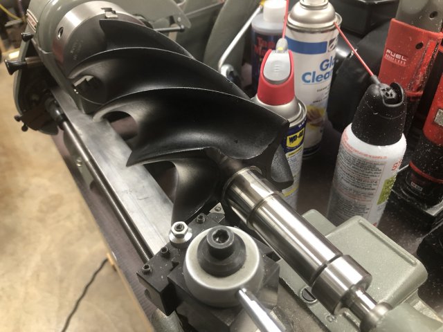

3,808
9,019

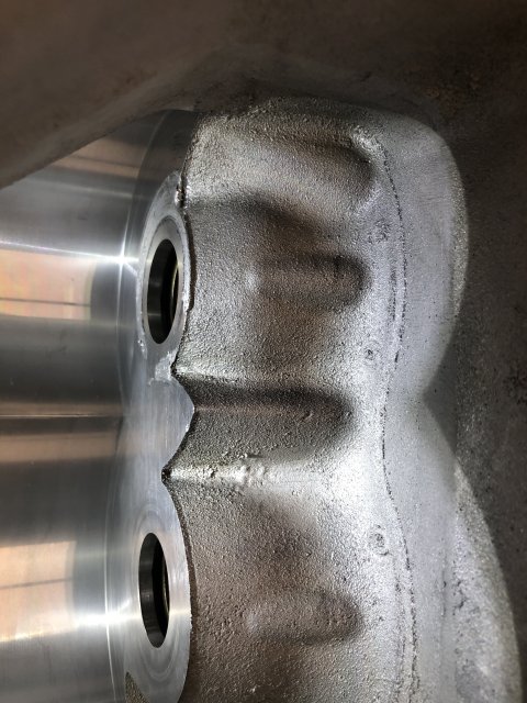

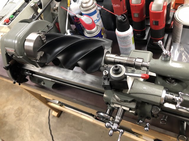

Turned galled up material off end of the rotor then Built up the end of the rotor with aluminum spray weld then faced it smooth and coated with Teflon just like OEM, no change in length.

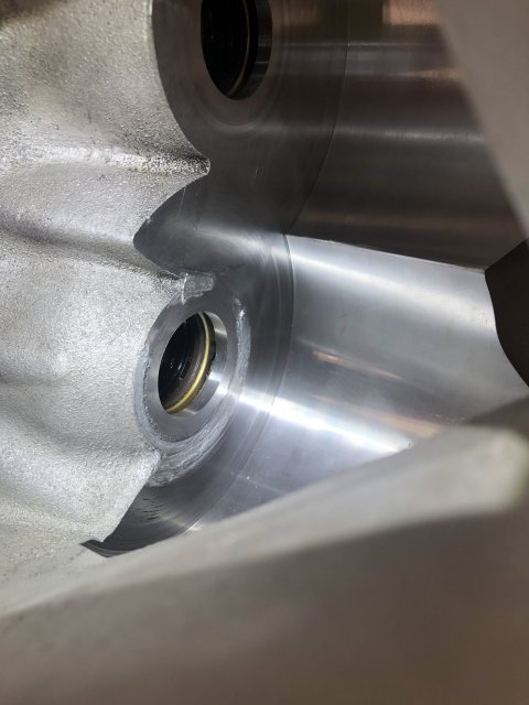

Back of case looked like this, facing it off next and doing the spray weld and reface to it too if it doesn’t clean up smooth, it will be good as new when finished. My worry is timing the rotors and preloading the bearings correctly on the gear end of the unit. I’ve got a plan, hoping it works.

@Speedy!
You added the PID "timing advance cyl 1" to your log data posted above. That's the actual timing.
You need to see if you can find the PID "iat advance" in diablo to add that to your log as well. That will be the amount of timing being removed as a result of IAT temp. I have mine set to start pulling timing above 130°F.

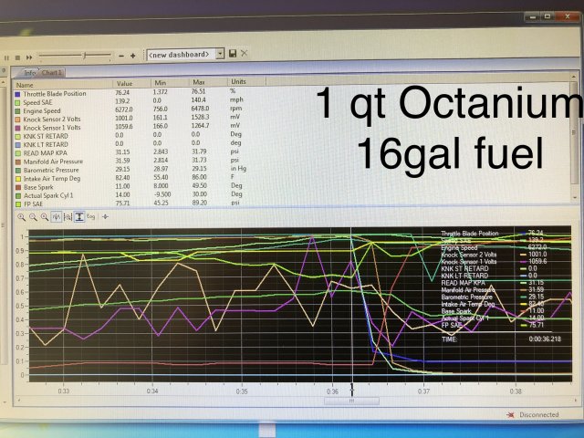

Ran car real low on gas the other night playing in Mexico. Filled up with Sunoco Ultra 93 and a Qt of VP Octanium, 16.5 gallons of fuel. Did a test pull and data log today to see how 1qt and a empty tank fairs before going out hunting tonight . Look at the knock sensor volts, this at almost 17.5 psi of boost. Tempted to give it a another half degree of timing up top. Easy on it street 1/4 netted 11.6 at 135, its a happy camper. Sure wish the tracks would open :(
