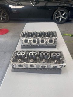

Mechanic states they are very pretty!

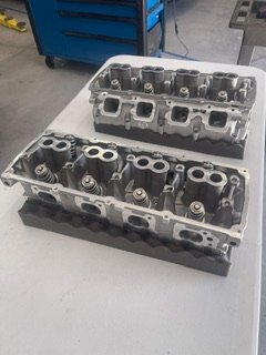

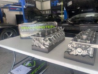

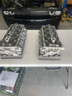

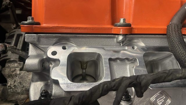

Frankenstein stage two fully assembled with slightly larger intake valves. Once together it will get dyno tuned remotely on my mechanics dyno.

I went back through the thread and saw they are ported. Heck I was thinking you had one of the AFR heads

Afr was having delay after delay. Not sure if they got the port matching problem fixed. After market heads are flow tested of course not being attached to the block and intake. Aftermarket ones may or may not port match.
Make sure you let us know what the gains were!!
