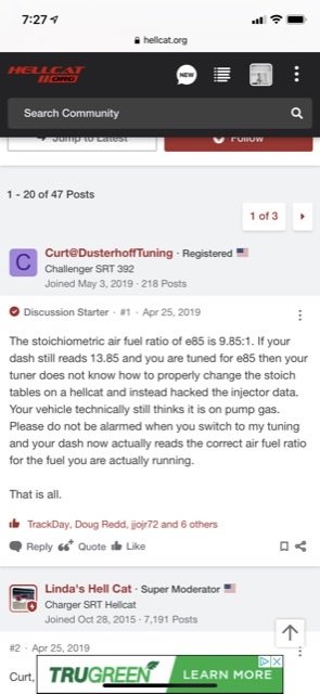

Here is a post by dusterhoff tuning. https://www.hellcat.org/threads/attention-all-modified-hellcats-running-e85.230179/

OP, your lambda is too low for pump fuel. 10.5/13.85 is even a little low for e85 which has different lean and rich maximum powers than pump fuel. You are leaving power on the table and if tuned at partial throttle too rich you can foul your plugs.

Bingo @jonx96 guess what my dash reads at idle on E85😎 I wouldn't say using the injector method is wrong per se but I wanted to set mine up as if it were factory tuned for E85. Takes a bit more work bur worth it IMO.
Plus when you have tunes for pump gasoline and E85 you'll know which tune and fuel is in the car by what the dash gauge reads.
If only we could change the dash to read lambda. The car actually reads lambda and converts to afr so woulda been an easy option.
