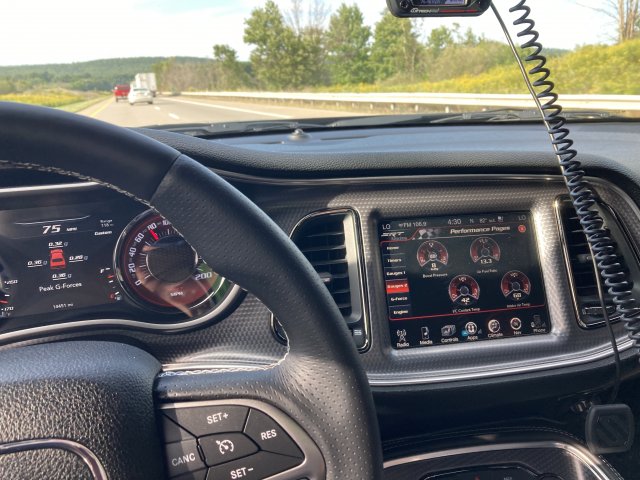

My drag size killer chiller the other day Tooling down the highway at 80, it’s on 100% of the time. Some show there temps at idle and very little load, here it is under load waiting for action. This is in mix mode cabin and inter cooler. Just intercooler, in drag mode, it’s even colder. 6F6F938D-22D7-4EBF-B378-C4A151FF77C0.jpeg

I dont get how your IAT is 68 when you ambient air is reading 82.
What am I missing?
16,878
52,875
#49
What am I missing?
Ideal Gas Law???
What am I missing?
Without his killer chiller, the IAT would be a good 25* higher than ambient temp.

Gauges are correct, IAT is always higher than I/C temp.

After a little research, I now understand.
I just assumed the IAT displayed was pre-supercharger air but it seems that it is actually post intercooled air.
Ha I'd hope so, or else the intercooler would be called an interheater.

Delta T should be 17 degrees difference or more.

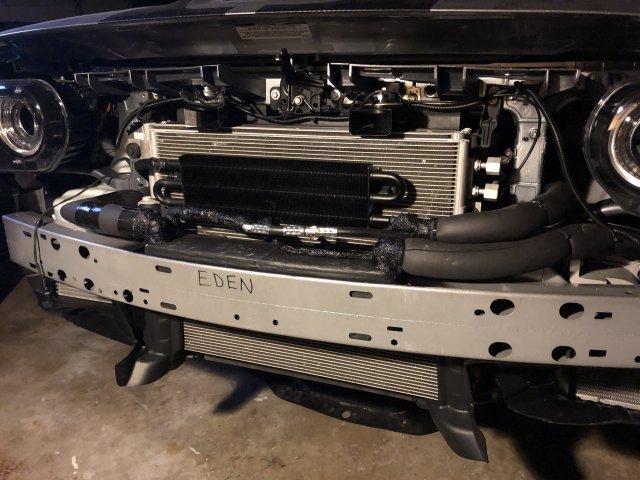

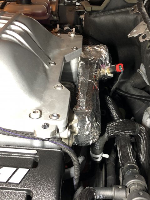

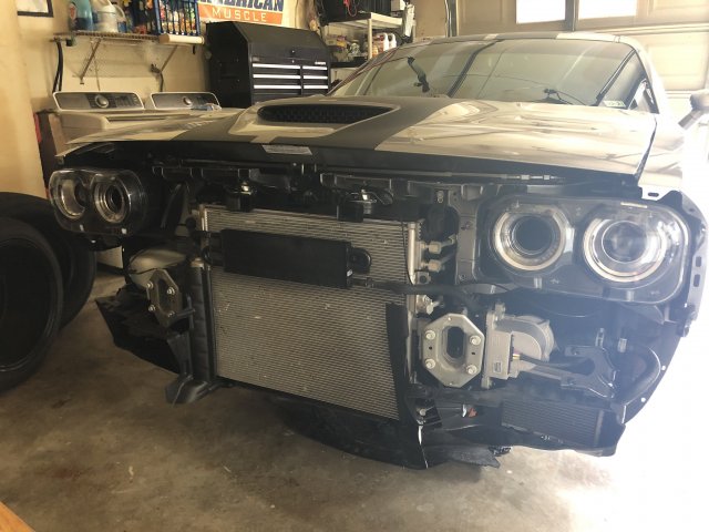

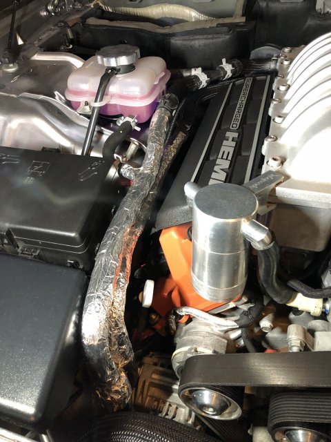

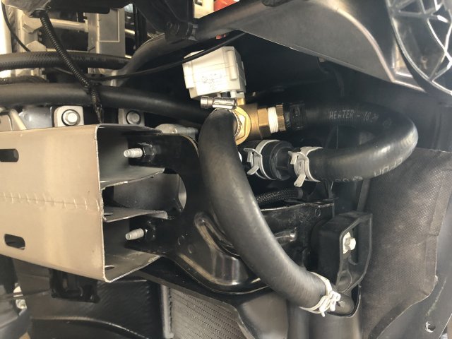

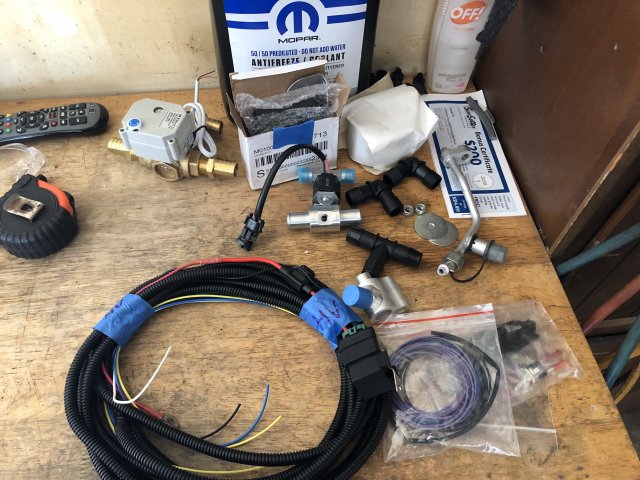

Well it wasn't too bad but it did take about 5 days to get it done, I did a lot of extra things that takes time like cleaning up behind the nose of the car while it was off & insulating the hard lines & I did the a/c vacuum & recharge also. I'm real happy with how it came out, still can run on stock heat exchangers or switch to chiller with cabin a/c or drag mode with no cabin a/c.
First time at the track I was seeing 37* & 39* I/C temps, depending on how long of a chill down b4 pass, I also saw low 40*s , the lowest I saw was 33*, the passes were in 77* / 80% humidity & DA at 2000, I ran 10.15,10.18 &10.20 at 134 & 135.70 mph.
At Mopar Fest it started in the 70's & went to 80's with 50 & 60% humidity at 2000 DA & I ran 10.05 & 10.08 at 135 & 136.76 mph. :p
