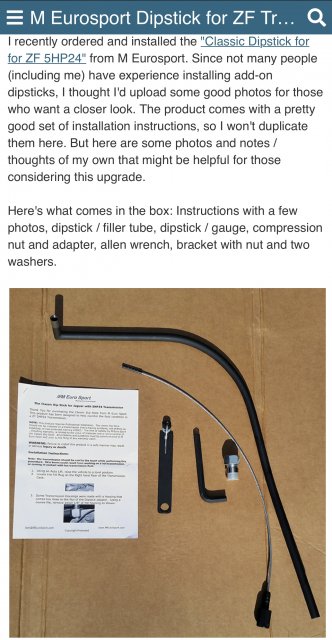

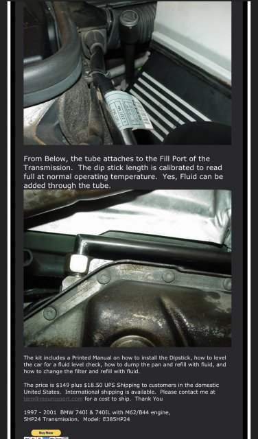

Fun fact, a company makes an aftermarket dipstick for the ZF in the bmw (also no factory dispstick) It’s just a tube that screws into the plug and goes up to the firewall. Someone needs to make the same thing for these.

If someone came up with a high-quality design for our Dodges', I would be a buyer x 3 in a heartbeat!
