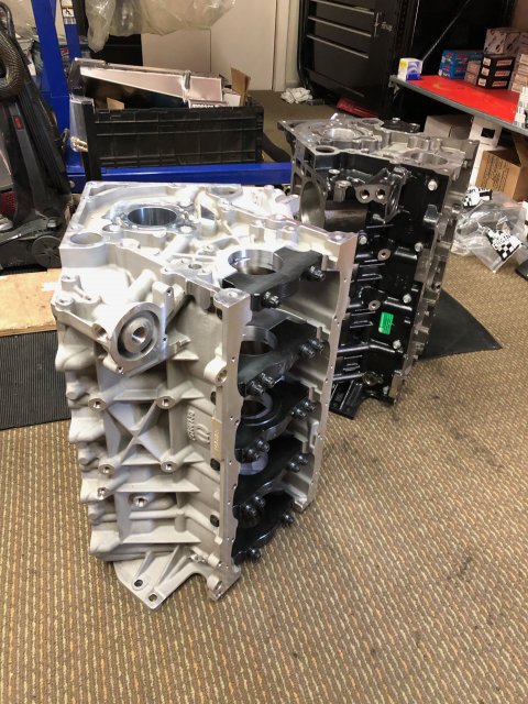

I just paid $7K for this alum. Big Gas Helephant block to build on. I know, you guys from that other forum may have seen this already :)

My builder says we will take around 130 lbs. off the front with the alum. block. Easily lifted the whole block off the ground myself. These blocks are almost impossible to get right now. FCA is limiting production to dedicated Hellephant builds and race teams. Notice the 4 bolt mains.
