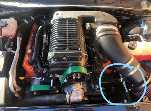

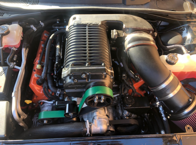

Here is a picture sent end of last week saying the car is complete: (Nothing was touched but the fuel line, told me it had all new whipple lines that were ordered when it still had the temporary hoses I installed in the meantime. Exactly how it left my hands :confused: - No insulation on any coolant/A/C lines )

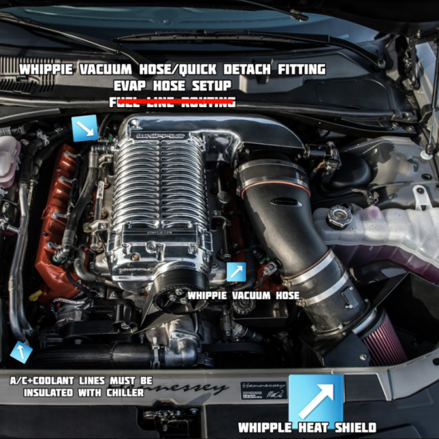

How i requested install and even sent this photo to help as a reference, it's little things but the only stuff i sent the car down for apart from tuning/chiller install, not sure how it could be missed:
Car will be back next Wednesday hopefully. They didn't order new whipple hoses or the airbox... Shop claimed whipple said airbox was back ordered etc. - Right after getting off the phone called whipple and had no issues if wanted to order one. Took a second look at the engine bay and it looks like the chiller lines are in the way now preventing installation of the airbox. Owner of shop said if i overnighted it he'd install for free.
It's really not how i wanted the engine bay. May order an airbox over winter and try to cut/modify around the line. Simply don't want the car in someone else hands anymore when basic stuff couldn't be done after months. This was all supposed to be done before the car was even finished being tuned too. 100% ruins all faith in the quality of work. Probably spent $300-$500 in shipping alone on peoples mistakes these past few months....
Final cost of labor $3200 to finish tuning/install chiller+new coolant reservoir (and not follow directions.) Said he was willing to deliver the car a few hours upstate which is something i guess.
Total cost to install this fucking whipple at two shops (without tuning) = $8000....... killed all interest in this hobby. Wish i never touched this car from stock as of now.
