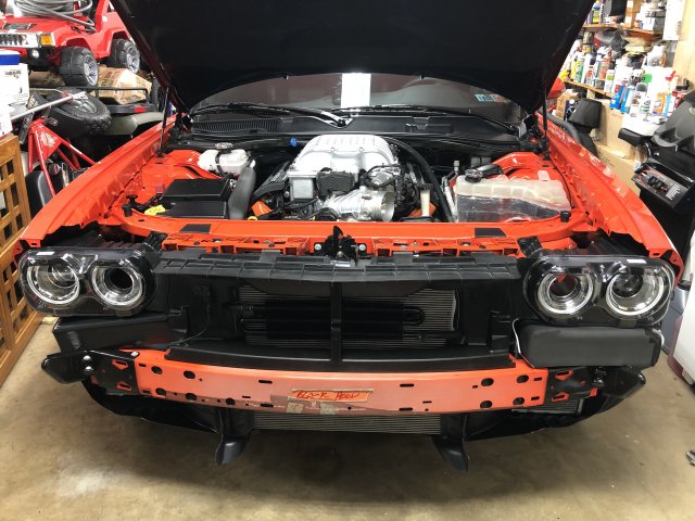

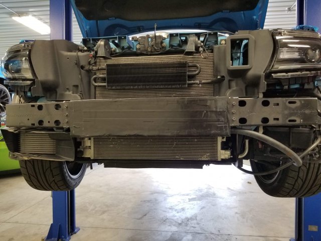

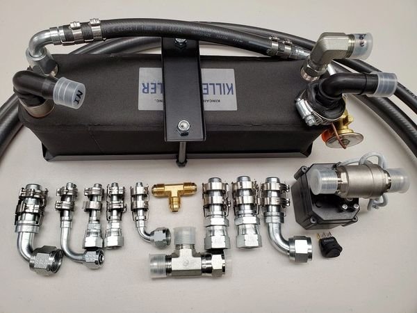

Just grabbed a Killer Chiller race drag system to cure IAT/Coolant temps. Not sure about adding the bigger reservoir. Might see how temps look before deciding if one is needed- unless ya'll that have one on a 4.5L know better.
View attachment 25041 View attachment 25045

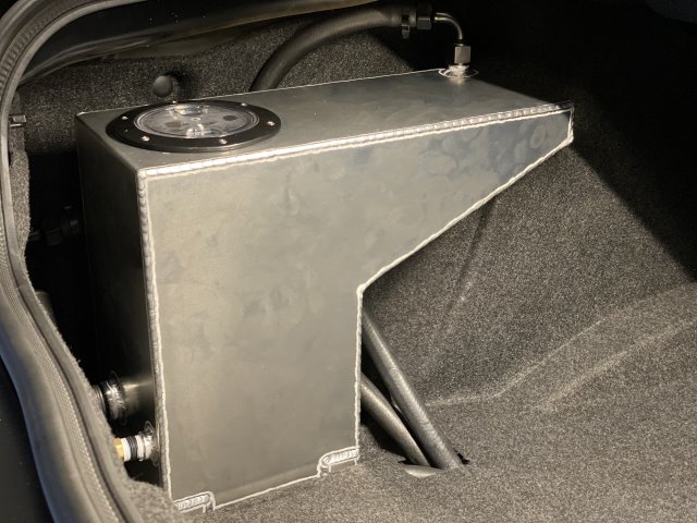

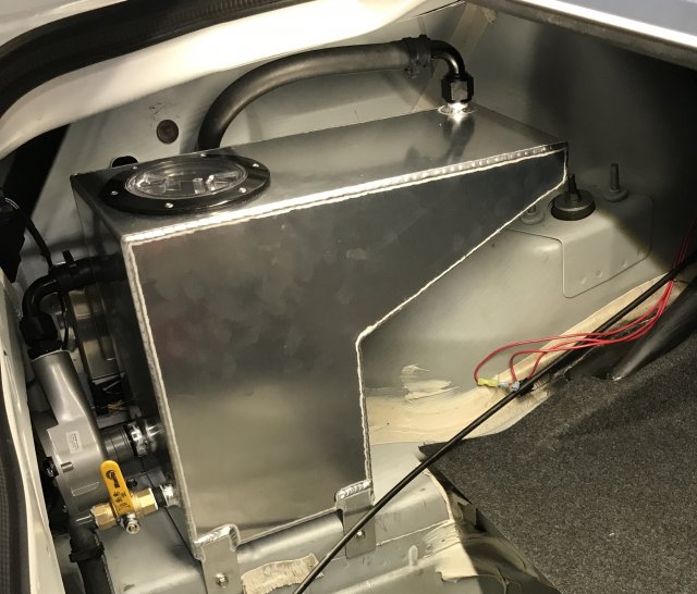

Highly recommend adding a reservoir, 1.5 - 2 gallons is ideal for 1/4 mile.
3,630
11,711
#49

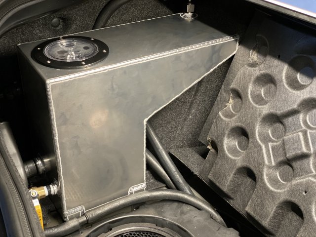

Agree. I went this route because with the shape of this tank, I can run that 2 gallons without uncovering the pump intake and I have the option of still using ice at the track. 72F19AA2-6F5F-4309-A895-EC6AEF1011C1.jpeg

I run a 2 gallon Gearhead tank in the front bumper. For $300 bucks it’s a great fit

Glad i went with the killer chiller system, never heard back from that guy in Florida. FI Interchiller would probably be a better option but wanted to stick with a US manufacturer.

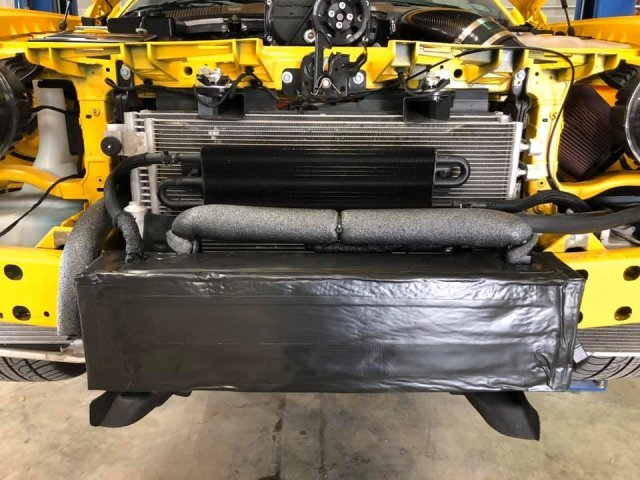

Yes 665DDE57-1429-4E20-A4AD-1F27F6936FB8.jpeg B0B8DC19-3FA0-4F60-81D4-074F4177725E.jpeg 88B32CA3-E0D0-49FE-A163-54D4131EB99A.jpeg

Wondering if the 13" 'race drag' version will fit in the same location. Going to check what the shop wants to do before ordering the Gearheadfab tank.

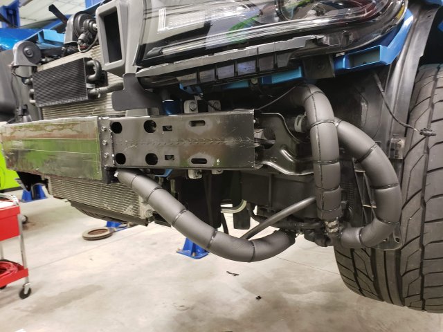

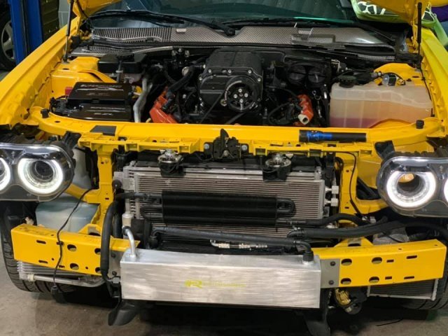

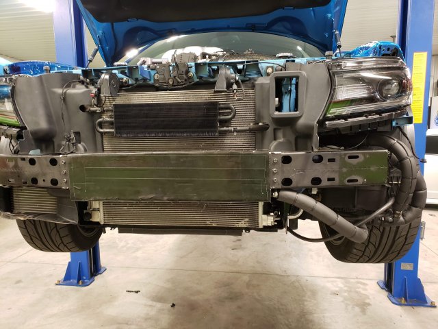

I like how 16GoManGoHC mounted the 14" chiller under the driverside light. Also made a custom 1.5 gal reservoir to go under the passenger side. Very clean install.

The 13” should fit same location

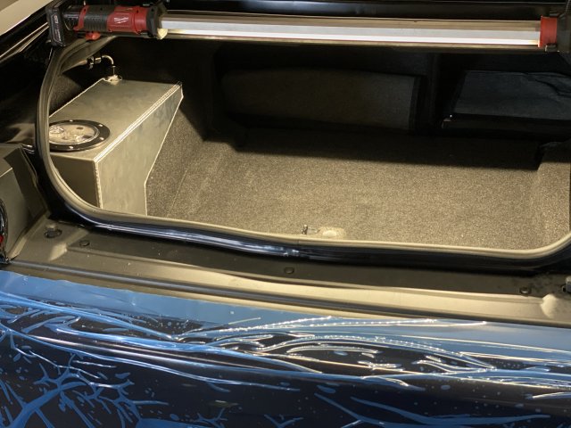

Check this out. Custom install by SRT AutoWorks.
We can load this bad boy up with lots of ice.
No need to remove sound system with this set up.
Easy to fill up too
4F4EFF5A-83AC-4061-9FAF-63AF0232529C.jpeg C1B1ECC9-7FBB-4B38-96CD-3106E108A7E3.jpeg 56EC364E-0A39-4BE0-8B75-2B5CBCB4BCF7.jpeg

Great response, however, IATs are much lower using an ice tank IMO. At Dan's event in Kentucky my IATs were below 90 F and it is was super hot day (well over 90 degrees). Maybe I am just ill informed, anyone with the chiller system seeing IATs in the 80s or below on a real hot day?
I went back and modified my previous post, it was too extreme
