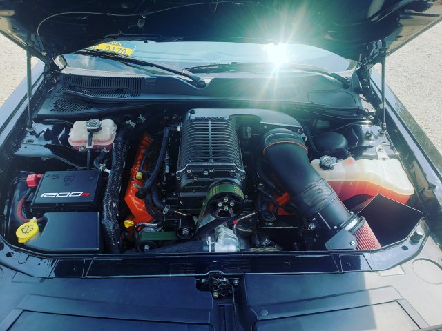

The Whipple 4.5 always looks way larger in the engine bay than any picture on the internet could ever indicate.

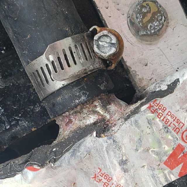

Still waiting on the car from paint/body work. Bumper is ready for paint and dimples for license plate have been shaved/filled for a smooth look. Shop is waiting on parts from Dodge, hopefully ready next week.

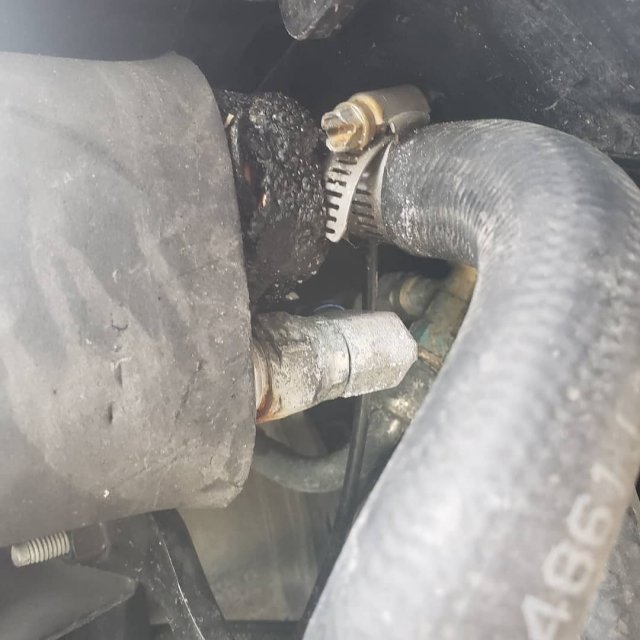

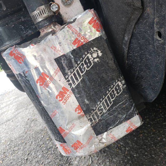

Got a look at the chiller system leak finally. It's pretty sad this work is on my Hellcat currently. Looks like a 1st grader welded the tank. Hacked together, even the body shop said it was shite. Top dollar for this...
If OST pulls off a miracle to save this car and get it show room quality somehow i will be EXTREMELY GRATEFUL. Tired of being burned left and right..so is my savings. Build a car they said it will be fun :unsure:

Gheezh the porosity on those welds, I’d have a new one made. That will not last long, already looks like it’s leaking.

100% having it all re-done. No way that level of work is staying on the car. Painful to just look at that crap. How someone could do this to a beautiful Hellcat I have no idea. Also no idea how the tuner is still advertising for this place on Instagram. Real shame.
Going to see what can be done to try to recover some money back from this hack job. With dyno services payed for never received, damage to paint/chassis, and now this pretty sure I have a decent case for faulty repair/negligent mechanic work. The BBB rating for them is now 'F' since someone had a similar situation right after mine. Same thing no response/resolution made them pay in cash. Unbelievable situation.

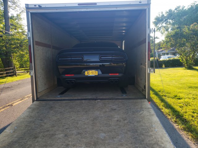

Thread Starter #214
And out of my hands again :eek:....pain is real but so close to being done. Has to be an end in sight soon enough!
Probably didn't need an enclosed trailer since the front bumper/hood needs to be re-done again but got a good deal from a local car guy. Why not for added peace of mind. Going to be a show quality car when finished anyway.
