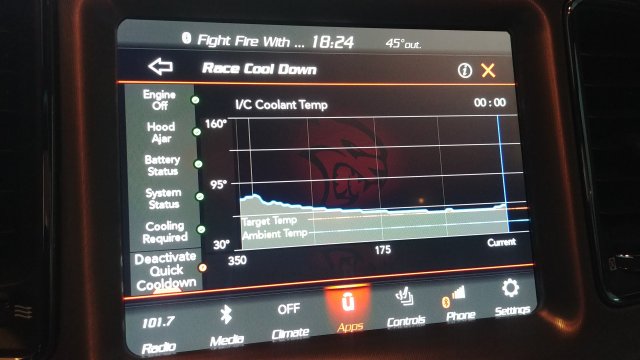

Race Cool Down is a neat little feature. The factory cooling fan moves a lot of air... it held a playing card to the grille. Which is about 2 inches in front of the heat exchanger, a/c condenser, and the radiator.

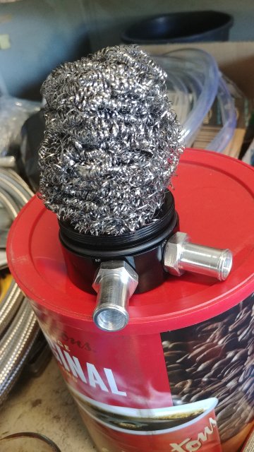

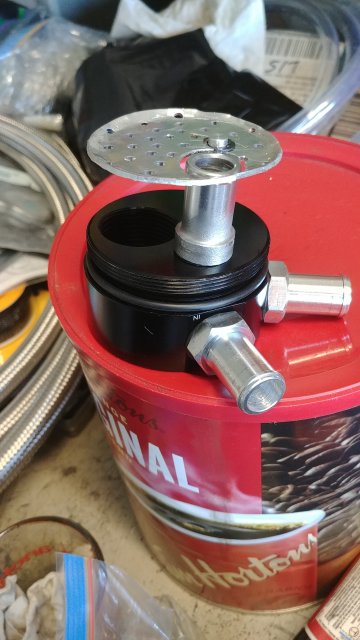

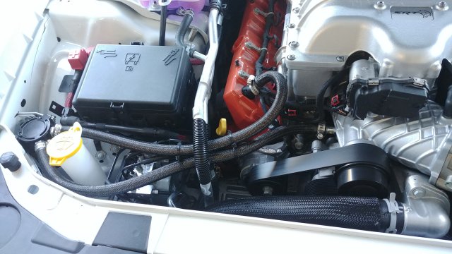

Did a little DIY project today. Bought a $20 catch can off eBay and gave it a few mods; like deleting the restrictive sintered bronze filter.
Built a bracket and made up some lines using some -10 AN line and some woven nylon sheathing. I was mortified to learn I didn't have the right size constant torque hose clamps - gotta get the hideous worm gear clamps off.
