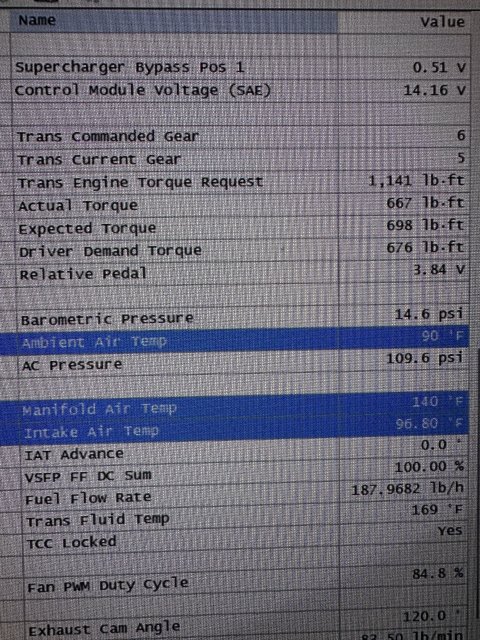

Thread Starter #66

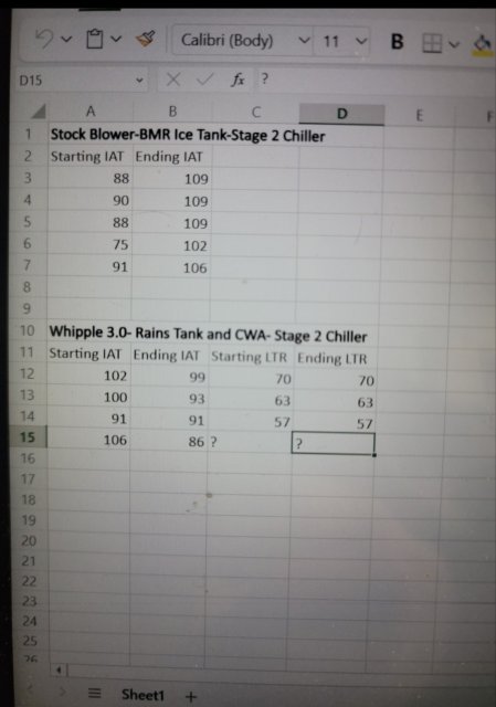

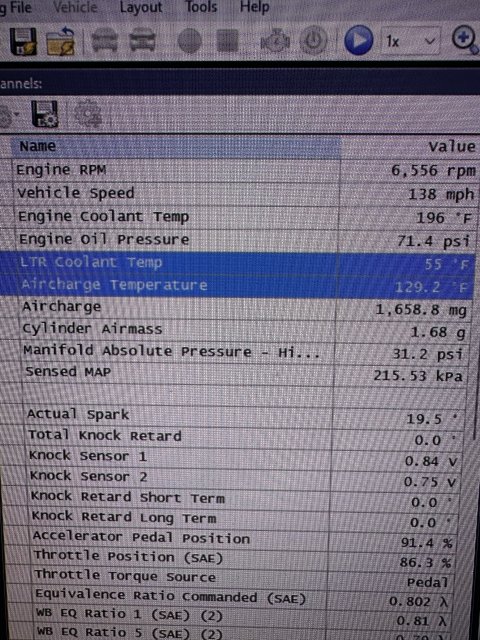

#70
More data is needed. And i wasnt logging IC temps before. But this gives a rough idea. Bare in mind on stock blower, that was 80 degree weather with IC temps reading 30s in the lanes. With the whipple it was also 80 degree weather

Thread Starter #71
More data is needed. And i wasnt logging IC temps before. But this gives a rough idea. Bear in mind on stock blower, that was 80 degree weather with IC temps reading 30s in the lanes. With the whipple it was also 80 degree weather
Nice, mine with stock blower 2.69 no aux tank and chiller was ending at 96 on a 90 degree day, I believe that was my hot lap as well. The big killer is manifold air temp

Thread Starter #72
Why are your starting LTR numbers so high with the CWA 400 pump? I guess that’s my point, the CWA isn’t needed and can actually cause issues with a chiller, it’s meant more for an ice box in my opinion and even then not needed. Your lower IATs are due to the whipple

#73
My g
My guess i wasbt giving it enough time before next run. Ill get more data and report back.

Thread Starter #74
and here’s the big difference for chiller vs non. No chiller, MAT was 172 - 2+ degrees of spark pulled for the top end of the track. With the chiller, MAT was 144, no spark pulled
