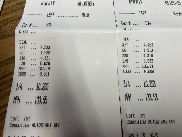

1.5's in the 60 with LC.

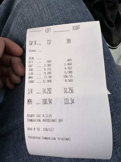

I was achieving consistent 1.4x 60 foots in Go Man Go but it took me years to get it dialed in.
