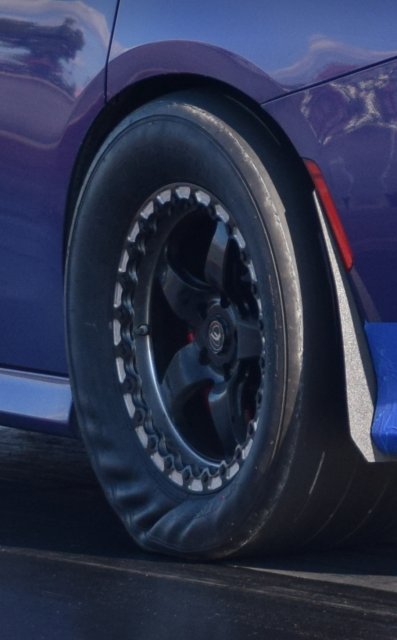

So launch control didn’t ruin your run once you lost traction?
Nope. If anything the opposite.
Can't say the track wasn't prepped either:
I'll be curious to see input on this. On my 2016 Hellcat, launch control was useless. SRT "said" it would control wheel spin to maximize forward momentum but that was never my experience. It'd just launch at the given RPM and immediately blow the tires off. I was always interested in it as a reaction time aid, but it never got off the line.
In the 170 I've not tried launch control yet, but did use the trans brake and it worked as advertised. I pulled 300ft/lbs at the launch and gradually fed power back in and ran my best time in the car on a basically unprepped track.
I'm wondering if some improvements were made on 2018+ programming to LC that make it work better. Ideally if it can work as advertised you'd already be WOT, boost building in the blower, staged, and all you're doing is taking your foot off the brake which would greatly improve RT.
I have heard the 18+ had the logic improved but I've never been able to try. I was building 4-5psi at ~1700rpm on the launch control. It's been as high as 6 during testing in my driveway. LOL. Much more than probably 1800 I'd imagine it would push thru. I know 2000 absolutely did.
