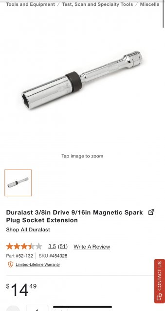

I guess the part number on the socket isn’t correct but this is exactly what it looks like (I know this one is the wrong size). You can put a socket wrench right on it and get them out without any additional extensions, maybe a 1” once on top of it for the back ones. Get this in 5/6. The magnetic part is amazing. Some of my best tools are duralast

And I have a screw in plug gapper, better than smacking them and having the pry it open if you hit it too hard

Just remember the hose trick to get the new ones in/started and it’s easy sailing. And yeah I torqued them dry to the insane 20+ ft lbs or whatever it was. @16GoManGoHC2 you do them dry, right? Recall the ft lbs on them? Been over 3 years since I changed mine last
