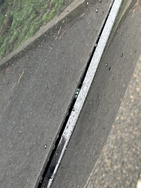

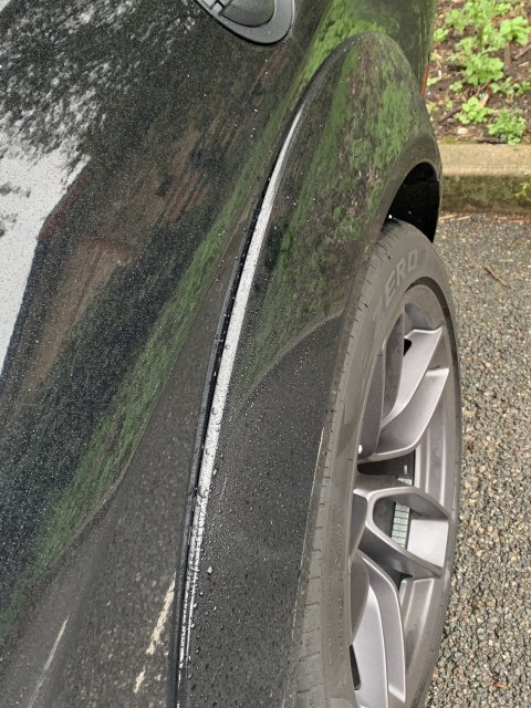

Noticed today one of the rear arch clips has popped off (nothing has hit it).
It was raining so I didn't fiddle with it and wondering what the best technique might be and better to ask before giving it a thump.
Thanks

Thump is appropriate. The rear flares install with clips only.

So did a fair bit of thumping, went back a bit but not fully. Called in local body shop to see what they thought, they had a go and no joy. Decided might be best to take it off and refit whole thing with some some new clips at the ready.
I had to replace a rear flare after a F250 opened a door into one. I don’t believe it’s common.
Did you get new clips for yours?
Had a look but can't find part number or what sort they are, is there somewhere better to look than this please:

I reused my original clips, the online parts catalog isn’t very clear what clips are used.

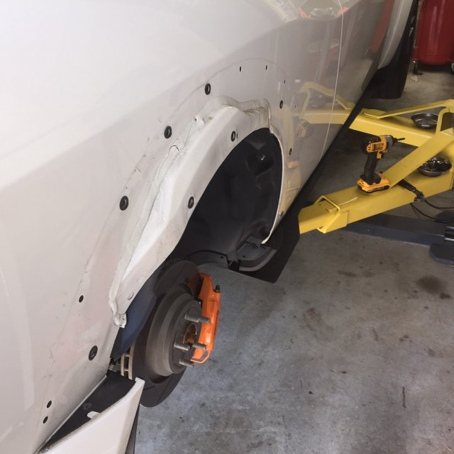

Best pics I have of the rear flares.
CA6292B5-4C0F-43EA-80A7-18567543440B.jpeg 06A4C3C4-DC50-48A5-908B-6D848A0DCBAC.jpeg
That's really helpful thanks very much (y)
