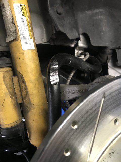

Also had to grind in the sway bar on passenger side , it does make you question structural integrity 🤔

Sorry but way too much grinding for me .
Hmmm. Probably unnecessary question but.... is the bar centered? I replaced my sway bar with a 1320 bar and did not have to grind any on the bar. The stock bar has ridges that place it in one position. The 1320 bar does not have those so it can be moved side to side to place it where you need to get it away from the wheel if it’s too close on one side.
It could be off some but checking clearance on other side there was much injury either
Didn't want to be a downer when the first pics of the chopping and grinding of the spindle was shown (cause it's a great post and I appreciate the sharing of info anyway) but for a street car I wouldn't the 15's. Track dedicated, I can see it.
Wish youda called me before you did this. Coulda helped you eliminate 90% of the grinding
