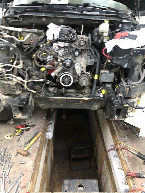

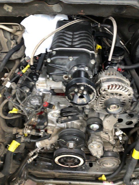

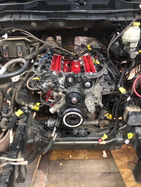

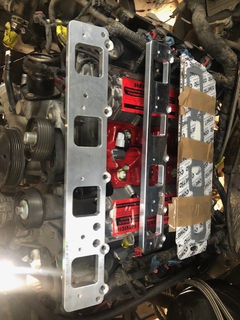

Yesterday I got the 12 mm allen socket, took the oil filter nipple off the 5.7 and it fit the 6.2! One thing not to forget is if you’re running a rear sump pan, be sure to knock out the dip stick plug before installing the oil pan. I completed the oiling system, filled her with synthetic M1 0-40 and a quart of Lucas, got her primed using a high torque drill and oil flow was great. I installed the valve covers, checked the spark plug gaps and installed,they were .028 (stock plugs were Bosch R6) before installing the coil packs.
