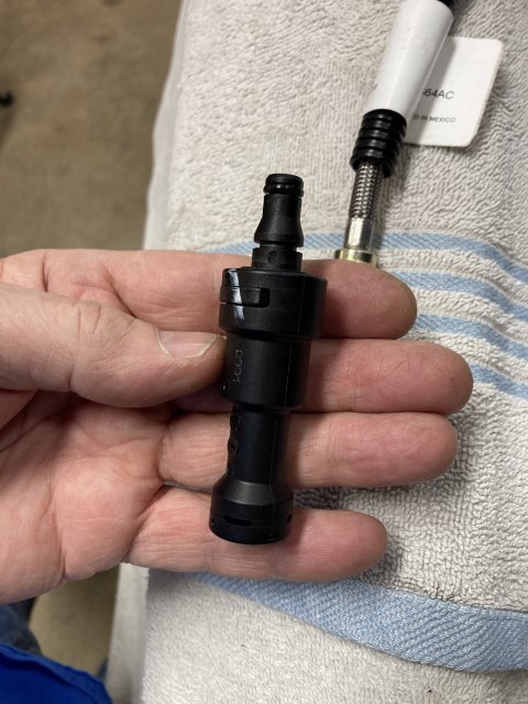

I think you maybe putting it on wrong? It doesn’t go through the holes s as bd out the other side it goes around them then some have white plastic cap to insure clip can not come out. I’ll see if I can find a picture.
3,322
7,856

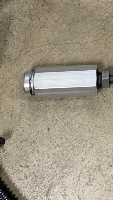

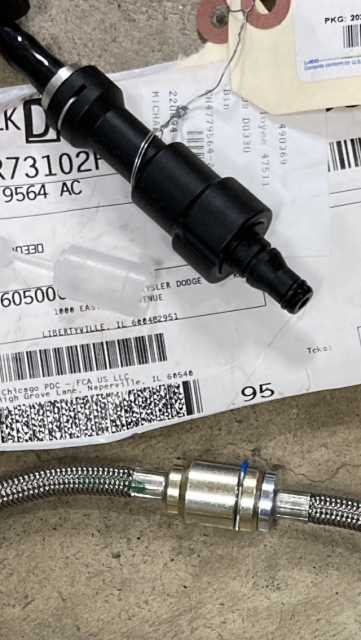

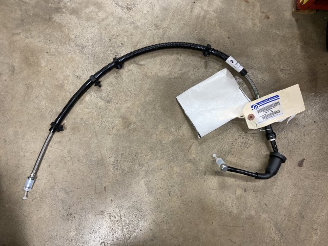

Here ya go, and BTW, the little blue X device is not the clutch delay valve. It is a restrictor to limit speed both in and out, the black device controls flow as well but allows full flow forward and restricts on the return, it’s called a flow check valve. It’s located under the brake booster where the clutch line comes through the firewall.

HA ! THATS IT ! I was trying to pu it INSIDE the grove...not around the outside . THANK YOU !

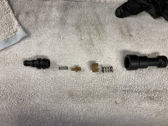

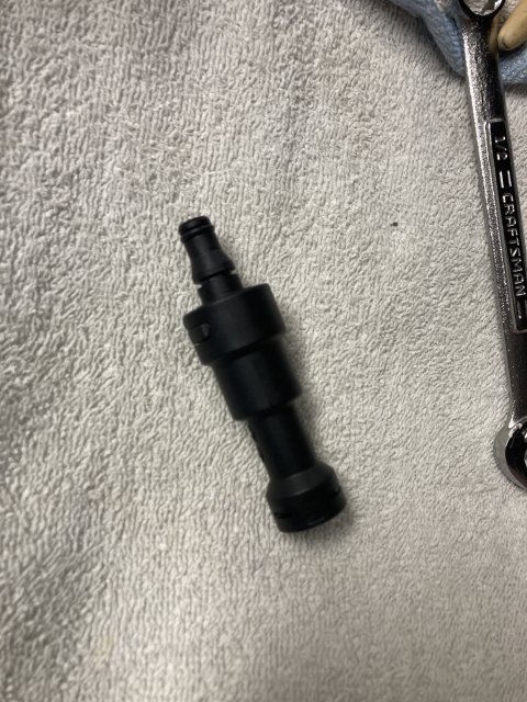

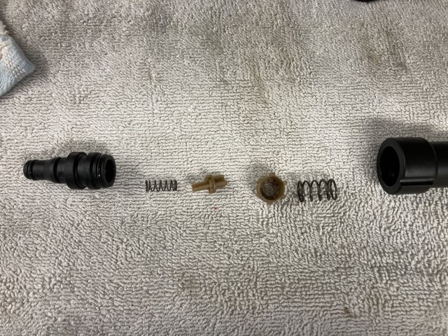

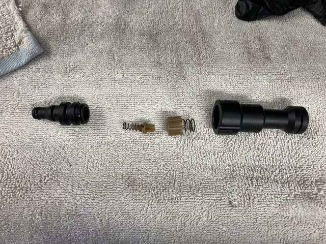

Here’s the guts from inside the black item which is the true Clutch Delay Valve. It’s very easy to take apart and clutch action difference is noticeable when gutted.
