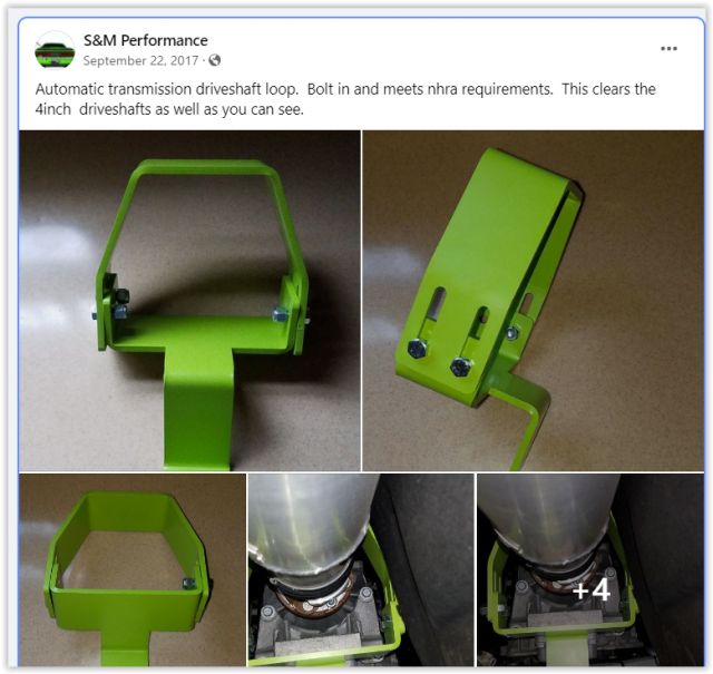

that's the same one I have, brand was "S&M Performance" at the time, although I am not sure who actually manufactured them; got mine from HHP also. I see they still have a FB page - might be worth an inquiry...

What I don't understand about these DS loops is it only protects the first 6 inches of breakage. On other vehicles I have had (older school), the loop was put about 18" behind the input of the transmission...
1,343
1,930
They located so closely because technically the loop has to be within the first so many inches of the first U-joint.
I run the S&M and it clears my Texas Speed headers and solo performance exhaust with a CCI 4-inch aluminum drive shaft without issue.
