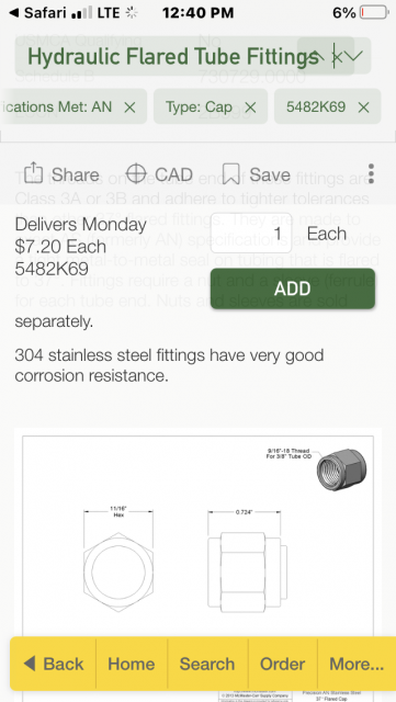

Take a look at these caps. There shouldn’t be any orings in them to worry about, they seal on the tapered flare. My only worry with welding a flared fitting to one of the end caps would be getting it so hot you melt the brazing that holds the cap on the end of the tube And the cap falls off while your welding with the fitting in it. I like your idea of having some way to drain your fuel easily but I don’t know how I would do it yet at the moment myself short of disconnecting the fuel line from the fuel rail which makes a little bit of a mess I agree. The material the is Cap made out of is too thin to successfully thread

Now that sounds more plausible, somewhere in this thread is the ID of the stock fuel rail, from memory it’s .625 or .675. Find a fitting with bigger threaded end then this, cut the cap off the fuel rail, turn down the threaded end of the fitting in a lathe for a tap fit into the fuel rail and then weld around the parting line. It would look great and be strong as hell. I have another set of fuel rails on the bench I could get the ID of the tune again pretty quickly and I’ll post it for you.

Found these that look about perfect: https://amzn.to/3s9Y0Y4

Just ordered them, looks promising
