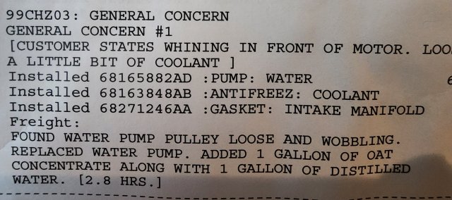

Dealer has confirmed water pump. Apparently there is a lot of play and decided not to drive home. Said it is worse than it sounds. Pump and thermostat arriving tomorrow morning. Said would be done tomorrow. Had no idea how close it was to failing.

Got Charger back today. Tech is a cool guy. Said he removed SC, which surprised me. Anyway, covered under my warranty minus $100 deductible. Quiet now...cannot believe I didn't catch this sooner.
