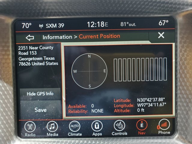

As I was trying to assess why my UConnect clock was off, I discovered that the Nav/GPS location was messed up in my car. Here is what I have found:
- The car thinks I am roughly 27 miles from my real location. Mostly north, and slightly east of my actual location.
- I used the "Current Position" page (inside the navigation screen) to tell me the GPS coordinates that the car think's I am at. I then looked up the GPS coordinates of my current location using Google Maps. The difference was about +.319 degrees latitude and +.096 degrees longitude from reality.
- I confirmed that the map location that the car was showing me was equivalent to it's faulty GPS coordinates. So it does know how to link those still.
- I confirmed that as I drove down my street, the Current Position data was updating/changing. It was not frozen.
I took a picture of the Current Position screen (attached). I do not know what it should look like on a fully working UConnect system. But it appears the only data it could show me were the bad coordinates.
Are the 12 vertical bars supposed to be a "strength of signal" indicator?
What is supposed to be showing in the compass area?
What is "Available: 0"?
Reliability is NONE - Yeah, I got that :p
And back to the clock - it was 8-9 minutes fast, and was set to 'Auto Set' via the GPS feature. I can workaround this just by going with manual settings for now, which I did.
Is there a way to reset/reboot the system?
Thanks!

Looks like you have a bad gps antenna or connection. You have 0 available satellites, for a decent 3d gps lock you want 4+.

I might be able to answer a few of these:
Yes......the verticle bars are an indicator. They indicate how many satellites you are receiving a signal from. In your case there looks to be 0. This is confirmed by where it says "available: 0"
The compass should be showing you which direction you are facing. There used to be, and there still might be, a way to do a manual compass calibration. It used to involve going to a big parking lot and driving in a circle for a specified amount of time or turns (sorry, I don't remember all the details). The directions used to be in the owners manual or you can probably find them online. Based on what I found for a 2017 Charger, the compass settings procedure begins on page 245.
It's weird that you're not even showing at least 1 or 2 satellites received (you need 3 minimum for the triangulation). It's typical to have 3 or 4 be really strong, and have a few more with weaker signals.
There may be info in some of the Charger forums on getting this to reset by pulling the right fuse and then putting it back forcing it into a reboot scenario.
There is a way to force a factory reset by manipulating some of the steering wheel buttons. I believe there are YouTube videos of those online.
Good luck

Good pic for the visual. That's what I would expect to see for a typical GPS signal display.

I considered doing that myself in my image, but I bravely left the coordinates showing because it was nowhere near my location! :D
It is still puzzling because I do believe it is seeing satelites - the coordinates change as I drive. It just seems like the software is really confused.
