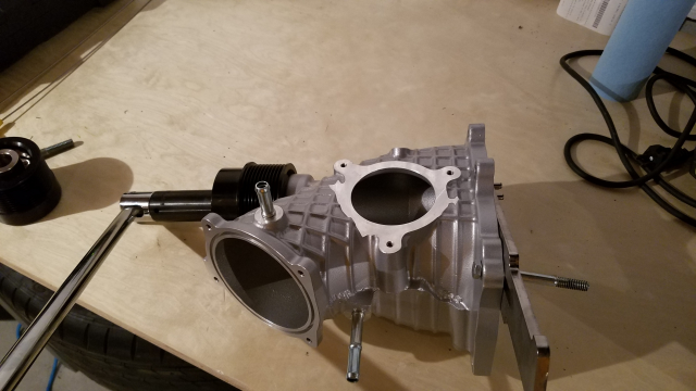

7. lift front front of SC up with crowbar or beaker bar zip tied around pulley lift by 1.5”, prop up each side with something soft & durable – I used rubber screwdriver handles...(bar provides a controlled lift so as not to disturb the steel intake gasket -mine was stuck on underside of SC) (note: pulley in this picture is the new one)

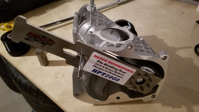

8. remove snout - to access (13mm) bolts you’ll need approx. 9” swivel extension socket, pull /wiggle snout straight back (retain the 6 dowel drive pin bushings seated in the SC housing as some might come out all together or simply need to be tapped back in, also ensure gasket remains unscathed –mine was stuck and didn’t move off the housing –perfect !)
9. create wood jig (tap/slam impression on end of 2”x 4”x 2’ - drill holes)

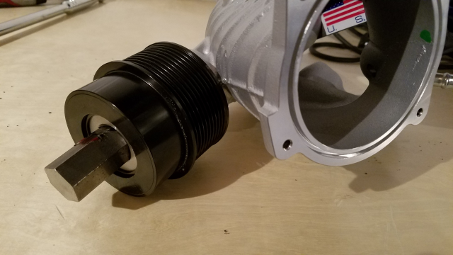

10. remove pulley with hex tool (recommended optional part with new pulley - get it !) / minimum 3/4” drive socket wrench with breaker bar, if needed, (DO NOT USE IMPACT GUN) turn CCW and with wood jig (leverage wood securely under a bolt placed in the upper right snout bolt hole -my inner bolt stayed put and pulley came off relatively easy)
11. screw on new pulley w/ locktight provided, torque 50-70ft.lbs (DO NOT USE IMPACT GUN) (i did 70ft.lbs. since Metco pulley does not have any run-on ((one way coupler)) the engine might try to back it off during deceleration conditions, who knows?)
