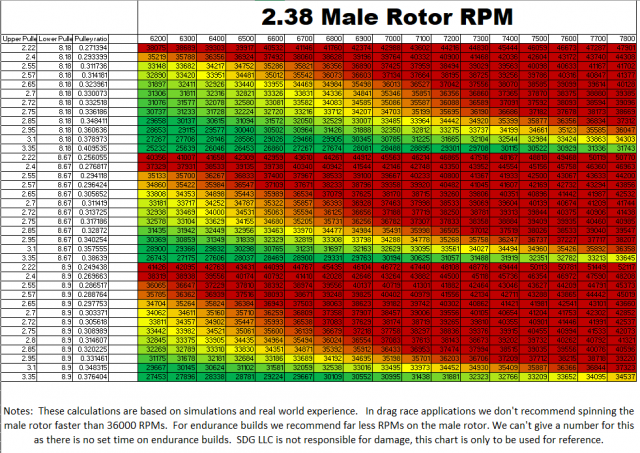

Thought this may help some out on here the 8,9 is the 10% od pulley the 8.67 is the IW 9% and the 8,18 is stock fyi this is from SDG motorsports page.Updated 12/3/20
