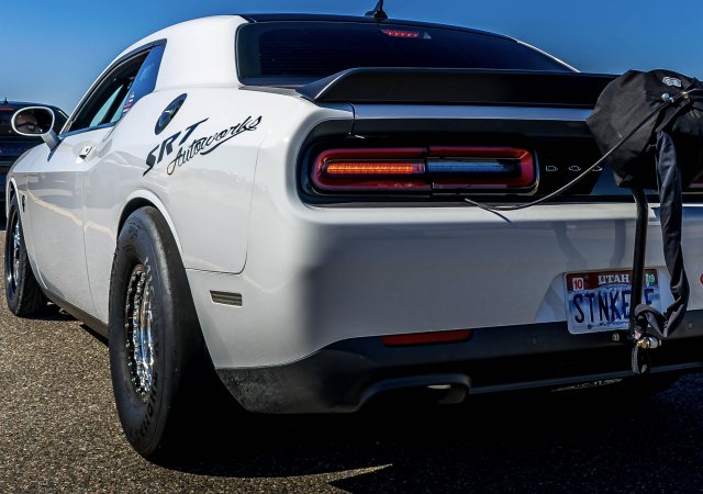

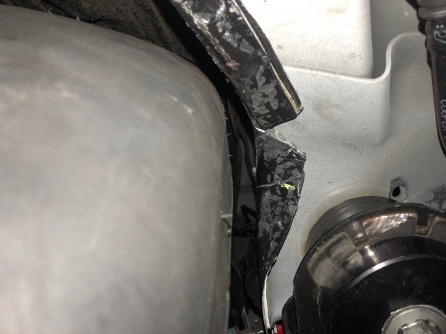

315/60-15 M/T Pro. Absolutely the biggest thing you’re going to get in there without ripping out the entire inner fender structure. E89A99F6-6B86-41F3-A177-F085C93A3C6D.jpeg 667E88C0-D6F7-4C69-AB1B-F49273D4E90E.jpeg

Hunter, Blkout - did you guys do work to the inside well like Marc did?
Thanks all for the great GREAT input.
I did not. Got hold of Biz @TRIUMPH
His wheels are amazing.
told him I was using the flares, he set up my wheels.
Have no idea on the offset, you would have to ask him.
But he worked with Bill at Phillips to design a wheel that had no inner issues.
PM me or @Blkout on Phillips.
Blkout
#1095
852
1,383
Warner Robins
No work inside the fender well, since the flares give you more width, the wheels have the offset to push them further outside the fenders.
