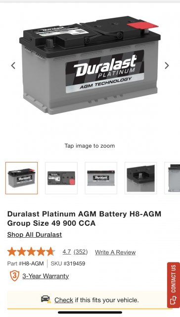

I’ve read good things here about this one:
