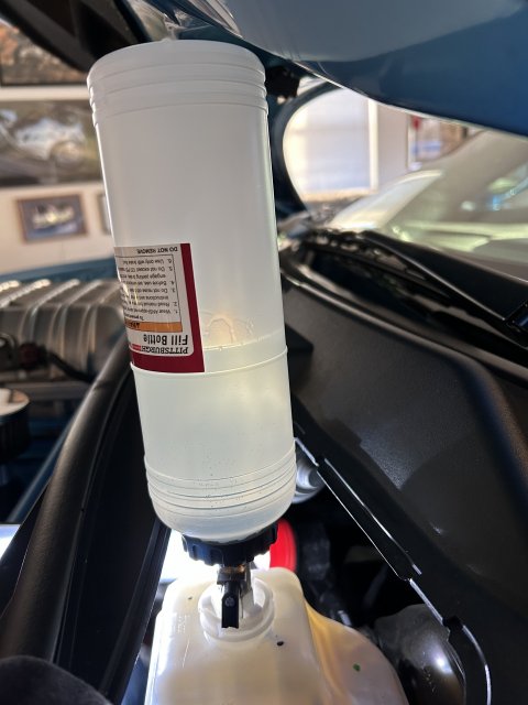

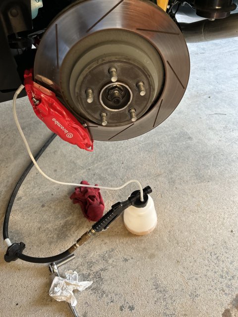

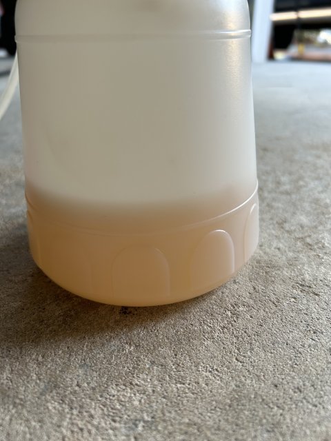

Does it include the clutch fluid being swapped out? What I mean to say are there two different processes? I did the rears and ran out of time time so I’ll pick it up tomorrow. I’m swapping out my 8 yr old oem with DO4, eventually finishing with Motol 5.1. I’ve still got to figure how to get my scan tool to activate the abs solenoid to get that fluid r&r’d but I understand that’s done after the bleeding anyway. I’m power bleeding them with air btw. So I guess the question is how do I do the clutch fluid? Btw, only 6.5k miles on the car but the fluid is discolored.

Did you bleed from both bleedscrews?
If only doing one screw, bleed from the outer screw?
I sure don't like that milky nature of that fluid, is that the O.E. fluid, or have you bled it once already with the 5.1?

Good am Bull. Yes, I used the Wiki page, very helpful, thanks. It is the original oem fluid and yes I did bleed from both inside and out and am wondering about the fluid in the line going to the tranny. I know the master cylinder serves the clutch, however I don’t recall anything in that post about the fluid in that line. Should I detach it at the point where the cdv is, have someone in the car pump the clutch while I observe the color change in fluid? I guess the time to do it would be in between the front calipers? Thanks.
