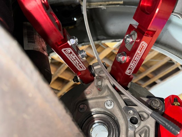

Showing off my DC bling bling
3,933
9,717
Yes these are the zero camber DC knuckles
Some assembly required

So DC products are available? Which one are not?

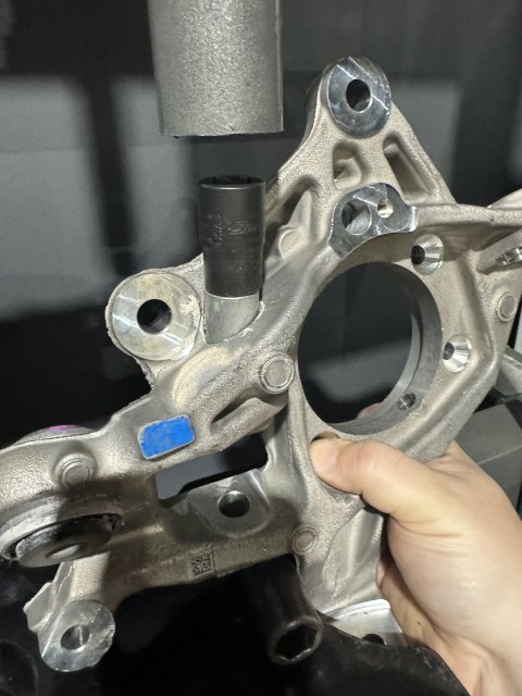

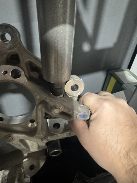

I need to get those. Strange they don’t install the metal bushing/collar
