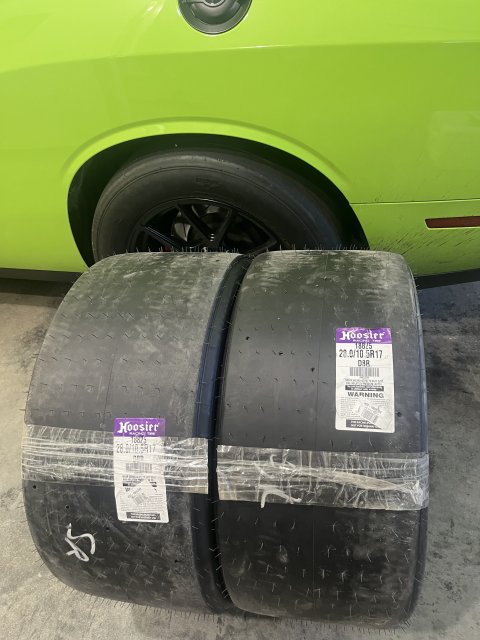

Got these. Made ALL the difference. 10B99F27-345C-4498-946F-A8EFDF9CE5F4.jpeg
6,332
41,258
I use to run Hoosiers on My 2010 SRT8 KB 3.6 Al 440 and loved them. Added more HP and my husband changed to MT's
What was the difference they made. Do you have a time slip comparison.
Thanks
~Linda

Hi Linda! Unfortunately, I never kept any slips from that place. My best pass Sunday was 7,14 @ 96mph. That's down from 7.60s with drag radials. I never competed there over the poor prep. Reguardless of what I dial I feel confidant it can be repeated. Now gotta work on that reaction time!
