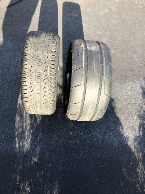

I dont find my Nitto 315/20 05R’s to be too squirmy, but I dont push the car too hard in the corners as I still have my Pirelli AS up front. Straight line I like them alot. In the rain or dampness they suck, but you can tell that by just looking at them. Not a problem though, just have to drive smart. 1C6A869C-654A-487A-BC23-F398C76E784F.jpeg

I dont find my Nitto 315/20 05R’s to be too squirmy, but I dont push the car too hard in the corners as I still have my Pirelli AS up front. Straight line I line them alot. In the rain or dampness they suck, but you can tell that by just looking at them. Not a problem though, just have to drive smart. View attachment 18304

I never intend on getting caught in the rain either, but it happens. Btw, I keep them at 29lbs. cold.
