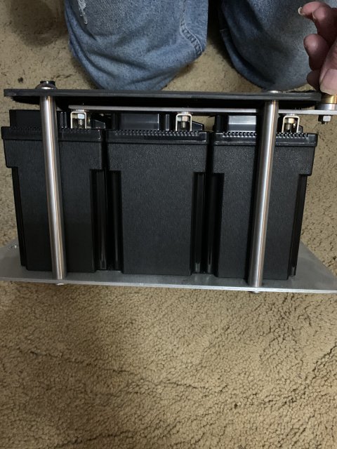

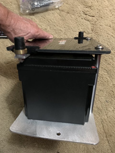

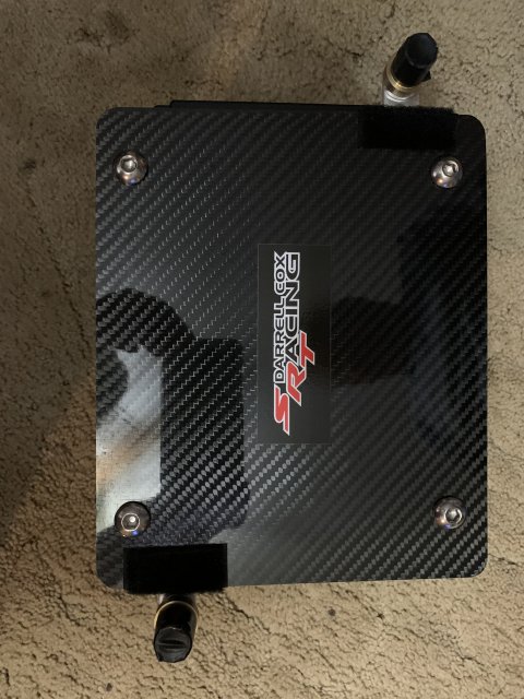

Had some new parts come in over the last few weeks. Got the AAD drag pack kit and the Darrell Cox Racing light weight battery kit. Trying to decide which axles to order now. Getting closer to having all the parts here so I can lower the cradle and change all the parts at once.

Battery Porn 7246D5BB-A164-4DB4-B443-F8B87FFC4F0B.jpeg 12D3FA38-E986-46F6-9B5F-CCC10431D6BD.jpeg E99C1DD8-AC1A-44CF-AA7B-1D9109BD663B.jpeg
