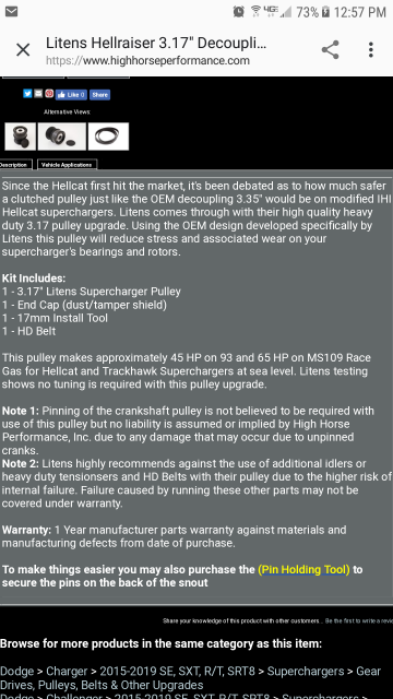

I should mention that my son talked the president of Litens today and was told that litens is or has come out with a 3.17 pulley that was tested on a stock hellcat. It made 50 more hp and didn't require any other modifications. That's right no tune no injectors just pulley. According to litens pres. The factory pc/tune compensates enough to be safe.
So if your not into doing all the other stuff like tuning data logging this might be the route to take

Thread Starter #11
Is that crank or at the wheel?

My concern about Liten's claims is that if you're in -DA, you may run short on fuel running that pulley without a tune. I don't know, which is why I said "may" ... If people are seeing STK with stock boost stock tune, they'll see it on more boost stock tune - but the stock tune may not be able to compensate quickly enough to save you from trouble.
Also, going through the hassle of putting a pulley on - just do the tune, make more power, be happier :cool:

To Jack's point, I've been wondering myself about how well that new pulley offering will truely integrate without a tune. An interesting engineering problem. Especially if you have to operate in a comparatively high temp environment.

I'd have to run some calcs to see what's what on the pulley and no tune. The wide bands are designed to adjust fueling to maintain a certain lambda value, and this may be just under their limit. I'd get with some tuners who've tested it to find out for sure.
