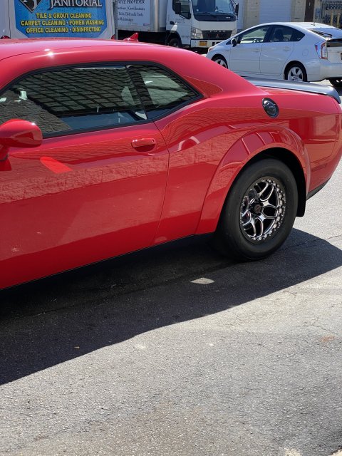

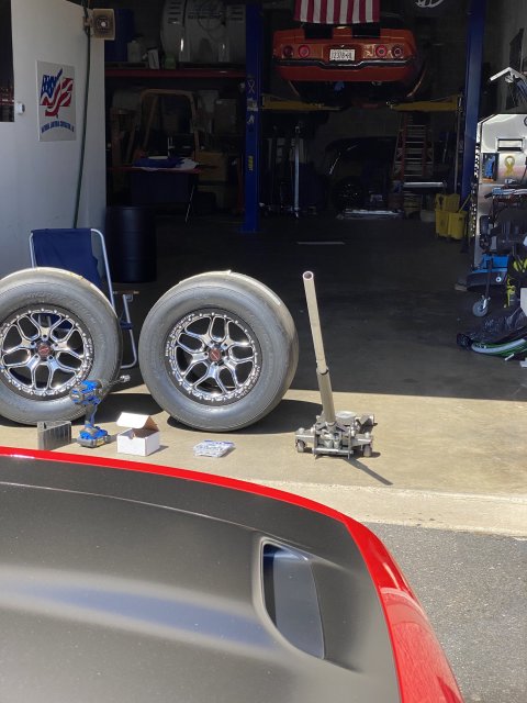

Guys, drag pack rear tires rubbing slightly “inside front” portion of the plastic wheel wells, just enough where it’s down to metal..have track event 4/20. Thinking a spacer? Suggestions on good product please. TIA
Car 2020 Super Stock
Rims 17” Billet Specialties.
Tires M/T
2,566
7,067
I don’t know about the required spacer width but I believe that guys who run the 315’s must hammer the front wheel well ribs and hit the plastic liners with the heat gun. Might be a quicker, cheaper, and safer alternative for you. Also, I assume the wheels are wide body “spec”, which are different than the standard HC wheel. They do appear a little inboard, but that can just be an angle appearance thing. Good luck either way. Nice car too!

I bet you have the wrong rims. With 5.25 back space you should not be close to anything even with a 315/50R17. Looking at that pic it looks like you have the wrong rims.

I do. Im pissed Ron!
Do fronts have specific back spacing? Thanks!

If you have the 18X5 Drag Pack front they only make it one way for the Hellcats (2.125" BS) So that will be fine.
If you have the 17X4.5 then you want the 2" back space. That is the one we run on the Demons.
On the fronts just be sure the balance weights do not hit the Caliper. On a 2020 Super Stock this should not be an issue.

Have the 18x5 with 2.125
SO PISSED about rears! Waiting to here back from Jegs! Thanks for your help/knowledge!
Guess my first track day will be on Stock rubber!

I’ve got to think if you bought the wheels with tires already mounted from Jegs you may have a shot. If you mounted the tires before fitting the rims I bet they are going to tell you you’re sool. Pls keep us advised, good luck.

I spoke to them.. They are seeing what they can do... Possibly a $2500 error on my part!

They sent you a Drag Pack rear wheel. Those are only made for the Narrow Body. Drag Packs were never built on a Wide Body.
If your invoice says "Dodge Wide Body Single Bead Lock Rear Wheel", then they definately sent you the wrong wheels.

That would suck. Good luck. @DRAGRCR so those wheels will work on a standard HC Challenger if 305’s MT’s were mounted?
Absolutely will work. 17X10 with 6.5 back space Billet Specialties Win Lite Drag Pack. You are golden with a 305/45.

Great thanks for the confirmation. Thought so.
