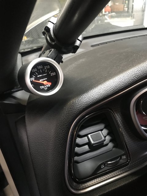

If the bars obstruct or block the install of a-pillar gauges, you could instead get roll cage mounted pods or windshield mounted suction pods for gauges instead.

As far as puller mounted gauges… Z’s right. Bar mounted pods are available. Here a old pic of my trans temp gauge. F1E4F26F-17F5-4D8F-A603-6304E5554387.jpeg

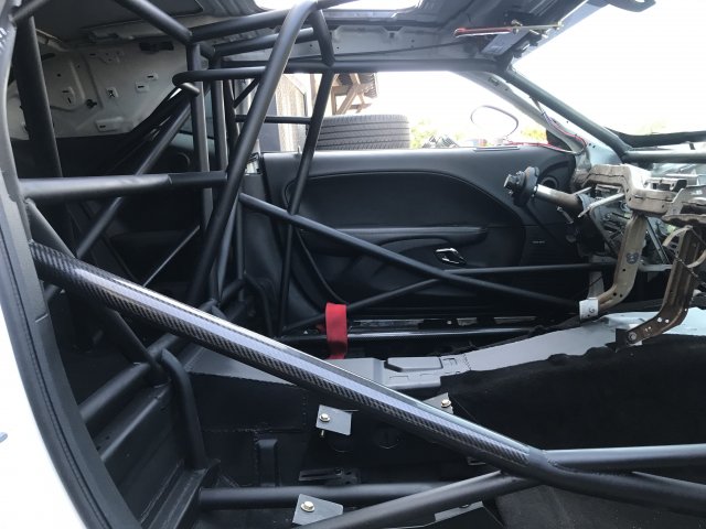

This is my cage when it was 8.5 cert. In street mode with the drivers side door bar out. Pretty easy to live with. 8F8961F6-34F3-4DED-8F3F-6D2C1F094847.jpeg

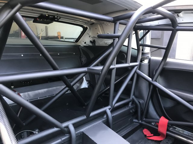

This is the upgrade to the 7.5 cert. lol. What a difference a second makes. 192CC5C7-E5E4-42D2-A605-382C4D6165CD.jpeg B8F685B7-F0D7-4ED5-BFAE-A7D1BCD08753.jpeg
