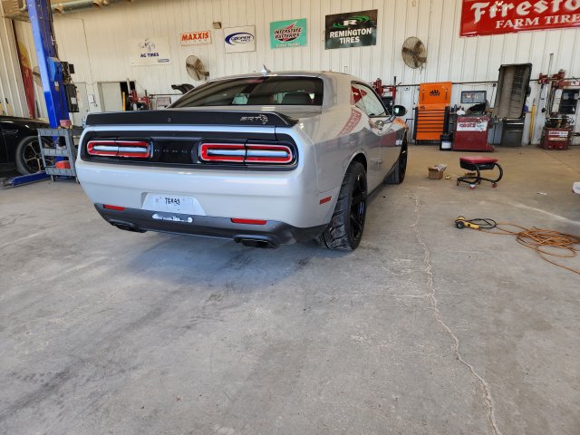

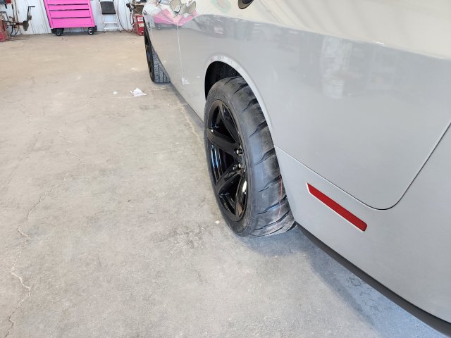

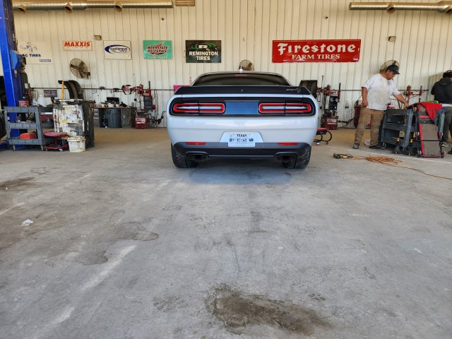

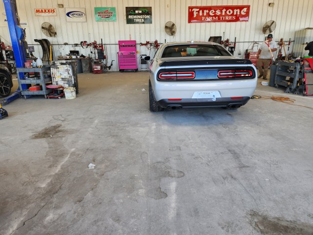

Photos....
20241025_130730.jpg Right Rear Quarter.jpg Rear View.jpg Left Rear QP.jpg 20241025_110708.jpg 20241025_110647.jpg

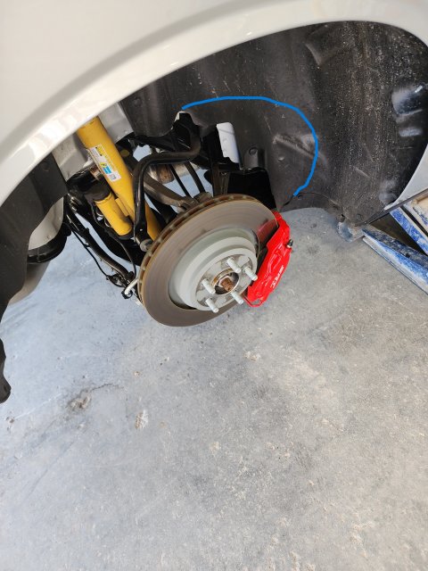

Here is the section we ended up cutting out of the liner, just FYI. Also, notice the seeming oil or other stain on the shock? It was not oily or greasy to the touch. Similar on both sides. Assuming it is something applied at the factory.

Looks good Mag. Normal residue on the shocks, not to worry. Go enjoy it.:love:

I took a heat gun to mine and re-formed the liner by just pushing on it with my hand. Haven't had a prob in 2 years.
20,163
I can see that. Took a heat gun to the right on first fitting and got it curl back nicely, but when put the wheel back on, the clearances at the corner (where the little bump and the transverse "strut" shaped roll is) were still a little close. Me and my buddy are old school - I just cut that whole piece out. While will keep things slung by the tires from hitting the unibody directly, they'll still transfer energy; and this car is just a nice day hooning around car. So, off with their heads.
