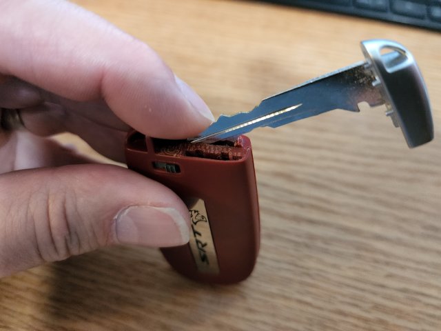

And the manual key that you remove can be used in the notch that becomes exposed to split the two halves easily in half.
