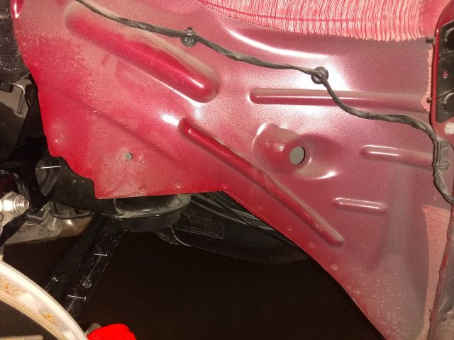

I can see this in your future, we can do yours first:p bring her over:giggle:
That's strike 1 for you
3,274
10,379
You got that right my friend ! I almost passed out when I seen the pic!
Wait till I show you the rear part of the trans tunnel and the entire floor in the rear seat area over the differential that’s going to get cut out to make room for that New differential housing and drive shaft going up and down. 🤯

actually I think I could do a nice job, trim it out an meg the seams back together. if we "F" UP then I know what not to do on mine.:love:

done that before had to support the unibody with 6 safety stands so nothing wrinkled.

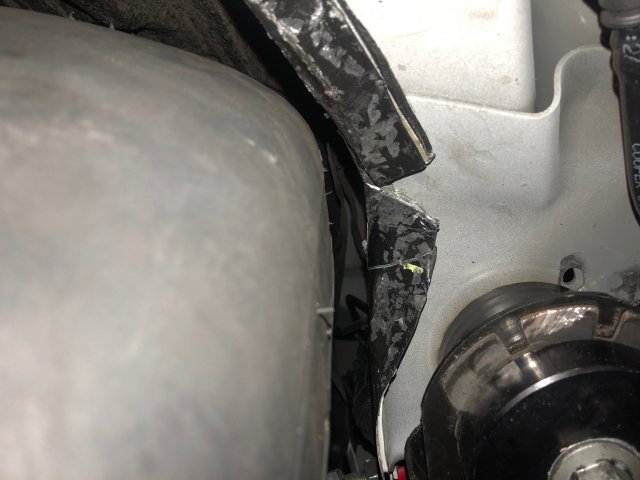

That and the area below on my car with the 315/60-15. That area below the rib where you can see the spot welds. I cut that with couple vertical cuts and beat that lip in and over. I don’t have a real good picture but you can see it in this picture looking up to show the tire clearance. View attachment 26202

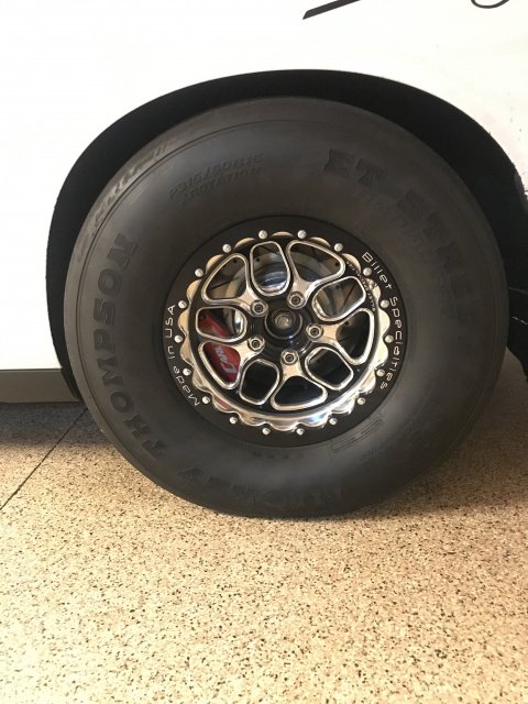

What's the backspacing or offset on those Billet wheels your using?

I would like to know as well ,went on their website an no specs for that wheel, want to see how it compares to forgstar d5

Carlyle said 6.5. He said that on the 15’s there is only that one bs. So.... same for both narrow and wide body cars. That bs keeps the tire inboard as much as possible, so it doesn’t stick out any more than necessary on the standard body cars and keeps it inside with the wide bodies.
