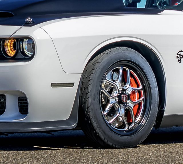

The 15” wheel with the 315 Radial Pro is the choice for the High Hp Hellcats. I started running that tire back in the day when I had still had the IRS suspension. Stock ride hight. No issues. IMG_9208.jpeg

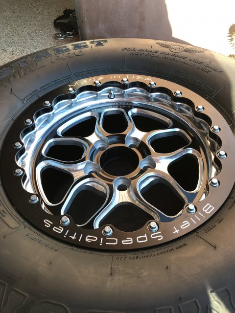

Billet Specialties Winlites. 18” frontrunners with 15x10 single beadlock rears. IMG_1405.jpeg IMG_9206.jpeg

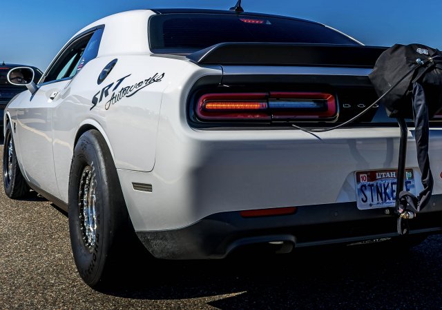

Then keep your fronts and use a 4 piston rear. If you go to tbm all around you will want a chute

Should be fine. Single piston calibers i’d never run without a chute (tbm) regardless of trap speed
