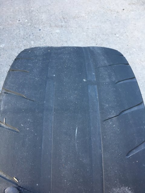

I've been running 315/35R20 Contis on 20x11s. I've had the PSI set to 29-30 for most of the tire life (which has been short).
They're worn and upon inspection they are showing heavier wear down the center--meaning they've been over inflated...
Thus my question... what PSI do people run with the wider rears to get even wear and an even contact patch? How low do you go? :)

I have not pulled out the old 315/35 on an 11" picture for a while. Does it resemble this? IMG_0585.JPG
