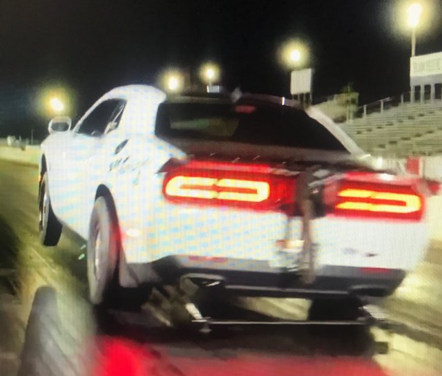

Exactly. Me….. I pull thru the box far enough to where the tire is wet but I’m out of the water. I move the shifter from 1st to 2nd gear and push the button on the shifter handle to engage the Hurst Roll Control (line lock). I hit the gas and when the rpm goes to 5000 (about one second), I shift to 3rd (high gear) and release the line lock at the same time. I count to two (watching the rpm) and let off the gas. I down shift back to 1st gear and stage. Then… I push the trans brake/2Step button on the steering wheel and floor the gas waiting on the yellow light. Yellow flickers…. I release the button and 1.1 seconds later the front wheels touch down at 60 mph and the track comes back into view. Simple as that. 🤓 29B68EE4-D06D-4A8C-8D60-82B7D23C26EF.jpeg

This hurst roll control, is it an easy install? Im looking to eliminate my tazer.

I've been trying to get one installed for 2 years. No one is sure about how to exactly install it.
