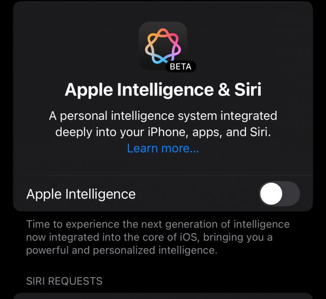

You are scaring me. I am thinking about taking that Durango out this evening, but maybe it is too cold, some of those gremlins are going to come out and nail me?
WTF, is AI changing my typing??? Seems like the last month or so, I need to be careful and proof everything because sometimes it is entirely NOT what I type! For example. That thing definitely changed that last simple “me” to “mine”. I have it entirely OFF and NO don’t do anything on my phone. I got Siri off also. It hates that for CarPlay, but I’m tricky.;)
