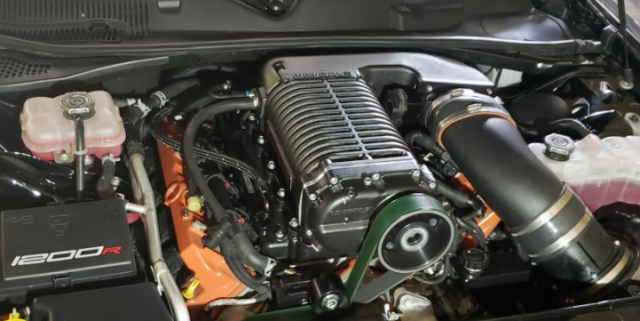

Not sure if this is a great idea.
Wouldn't be going past 50mph or into boost. Date to fix the cooling/interchiller on the 4.5L whipple cat is about 3 months out so would give time to fix paint/body work issues in the meantime.
Any risk of damaging the S/C or cooling system even more? Can wait but would be ideal to get the paint/body work done so this car is ready just in time for nice weather. (y):unsure:

Nope, decided against it and will just wait. One shop said it was okay, another said to pull the IC fuse. Don't really need any more damage so mission aborted. Could trailer it over to paint but not paying someone to go 10 miles.

I wouldn't personally.
3,934
9,719
Not a good idea ever, I mean just because you are not in boost doesn't mean the pulley isn't spinning and making heat.

See, now I would have done this, with the strict restrictions in place.
Short drive, no boost.
I'd be more concerned about the coolant pump than I would be about lack of charge air cooling in what should be basically a bypass/vacuum condition for the motor.
Of course, "better safe than sorry" may be the correct thinking.

There are supercharged cars without intercoolers. I would pull the fuse for the pump so it isn't running like Bull said and drive it

Just tow it. Can’t be that expensive

Pump with no fluid is a no no. You might make it, but you'll have taken some life span off that pump and it might drop out on you at an inopportune moment. Borrow a friends trailer. If I was nearby I'd be over there with my flatbed this weekend.

With our tuning developed around the charge air being cooled, the idea is to not operate too far outside of expected regions.
Hence staying out of boost, and therefore adding heat.

-And to the OP....good call. I wouldn't drive it either without the intercooler working either. Not worth the risk, and not tuned for running like that.

You can flatbed tow it 40 times for the same price of fixing it if you do accidentally melt it down.

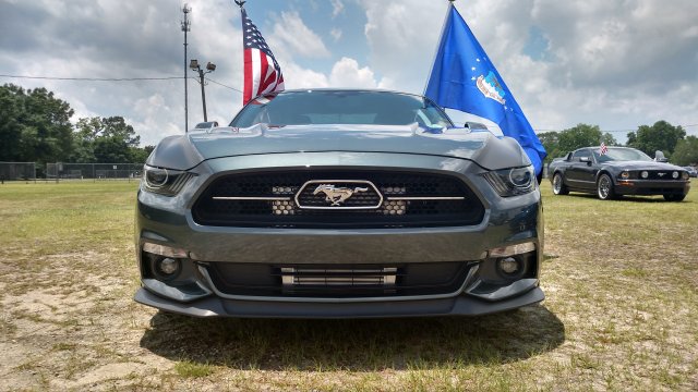

I made plenty of power with a Vortech and no intercooler
And I made more power with a ProCharger and a GIGANTIC intercooler:
