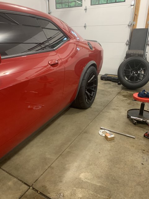

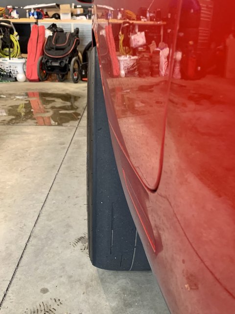

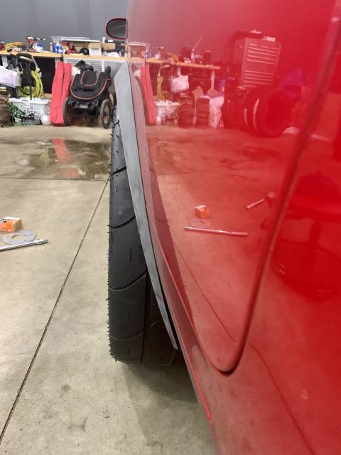

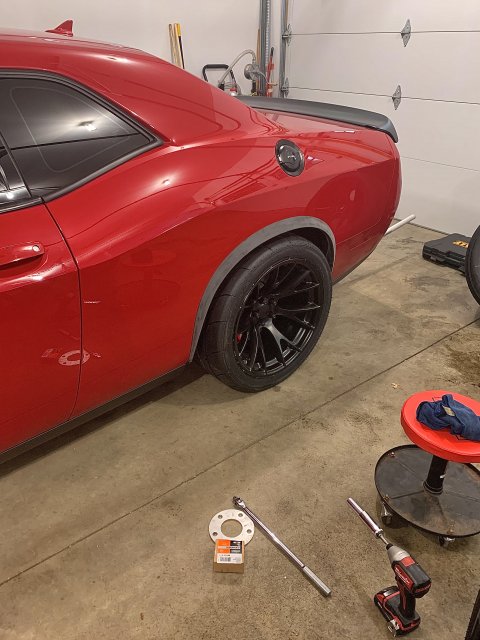

In case anyone is wondering what this looks like, I’m trying out the Lil devils with WB wheels. It actually looks great in person. The pics don’t do it justice. Once I get them painted and the ZL1flaps on, I’ll post more pics. In the last 2 pics you can see what the difference in poke is with no flares and 18x10 +20 Bravado Tribute and a 305/45/18 ET R vs the flares with 20x11 -2.5 and a 305/35/20 ET SS.
FYI:The 11” WB wheels will have 6.2mm more poke than the aftermarket 11.5” wheels that Phillips recommends. It wasn’t much difference so I wanted to try this first since I haven’t seen anyone do it before. It’s an aggressive look and looks really good in person as I mentioned.

That actually looks like a good pairing. Those are factory WB rims in that pic? Cause they don't seem to poke out as much as I thought and the Phillps cover them nicely but not too much.

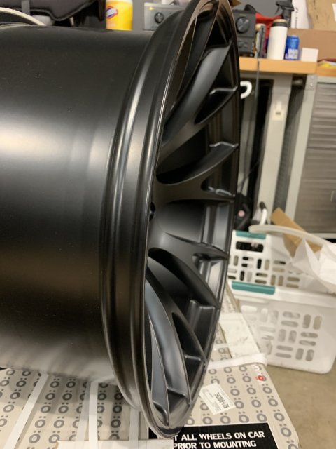

Correct, Voxx Replicas using the same OE size (20x11 -2.5). I love how concave they are which is why I wanted to try them so bad. Plus FAR less money than a forged custom set.

Voxx Replicas with identical to Oem widebody specs, yes. 20x11 with -2.5mm offset. I will definitely post pics when I’m done. I’ll also be using the 20x10.5s +25 on the front with a 15mm hubcentric spacer, longer ARP studs and ET lugs. I haven’t seen anyone else run the widebody rear wheels with these flares so I figured I’d be the guinea pig!

@HellcatMatt how much space are you giving away on the inner side of the tire, against the plastic wheel well liner? Seems we would want that as close as practical.
