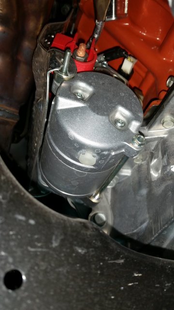

I was changing the oil on my 2016 Challenger Hellcat and noticed this threaded stud on the front of my starter and where a heat shield was over the stud. Does anyone know if a nut belongs on this stud? I would think it should as the shroud rattled when I move it. If anyone has access to theirs can you please check it and maybe get a picture. I would like to see what style belongs. Also a guess on the size? I’m betting it got missed on the assembly as my car has less than 8,000 miles. Thank you.

Typically, a starter nut is just your basic hex nut. No nyloc, no flange. But for a Cat, I can't say for sure.

Just looking at pic, I would say it is a 10MM 1.5Thread pitch for the nut...not positive, just going by pic.

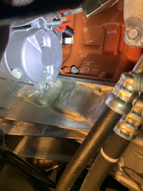

I vaguely recall mine looking the same way.
But no picture at the moment.

I did find a picture!
I am guessing the nut would have a flange on it go hold the shroud in place. I couldn’t see a mark where one was though.
Thanks Bull, none on yours either.
16,088
50,465
The reason I took that picture was there was a maintenance alert that went out (didn't rise to the level of a recall) for the mounting bolts torque on the starter.
I remembered thinking the same thing as you about a missing bolt or not.

My 2017 was missing also. I put one on it. Like you said it rattled when you bumped it.

Mine was missing as well on my 2016, it’s a standard metric nut. M8 I believe it was

And I see Kenny G assembled your motor.
Also, might that only by used for alignment somehow during assembly? I don't see FCA dumping the nut for weight savings on these porkers, or the workers screwing up on every car (though it is Dodge).
Ya good catch, I was wondering if anyone would catch that. I was thinking more Kelvin Gonzalez. Would be interesting to keep a running list and see how many different initials are on people’s engines. I can’t see one on Bull’s because the angle of the picture.
KG has come up before. Someone was quiping that it was "Kill Gringos"

Just noticed that same thing on my Redeye last week. Timing of this thread is kind of a coincidence. Starter heat shield rattling. Bought a plastic insert nut, a rubber washer and metal washer and snugged them on. Takes an M5 metric nut
