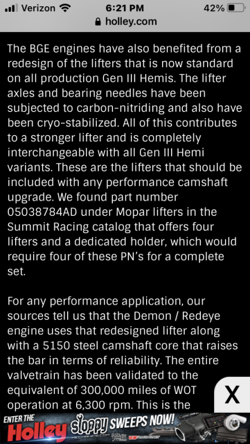

Did their instructions say to soak them in oil overnight? I’ve heard of too many issues with the Johnson lifters and just use the stock Redeye ones, their excellent lifters.

A bit yes from the Johnson lifters. They all well engineered and after 2018 all Hellcat and RE engines were fitted with them. I’ve never read of any failures or issues with them. The 170 uses them as well including the same RE cam shaft.

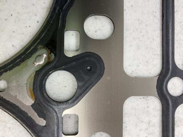

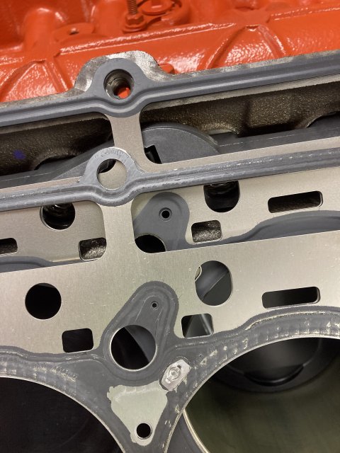

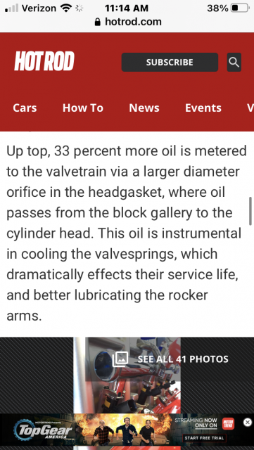

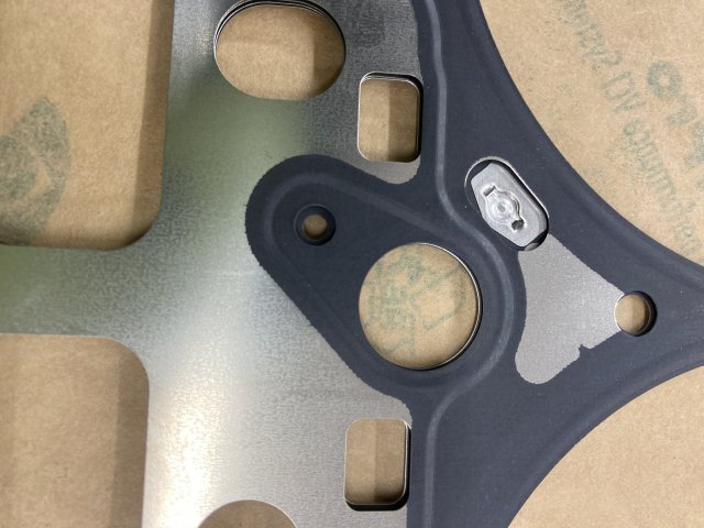

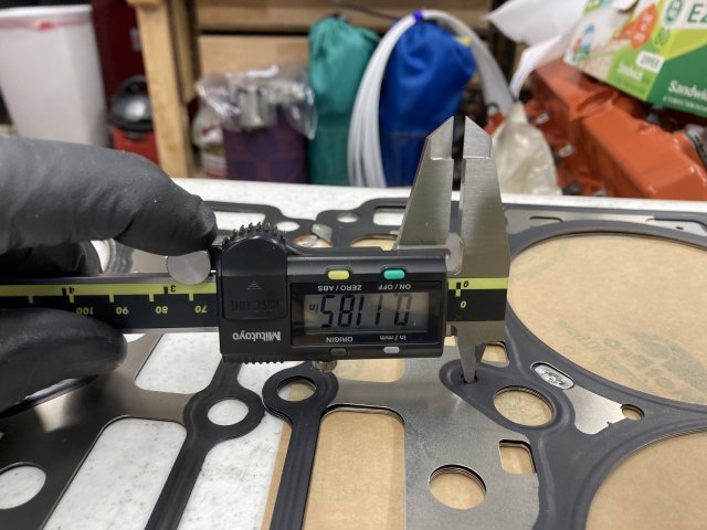

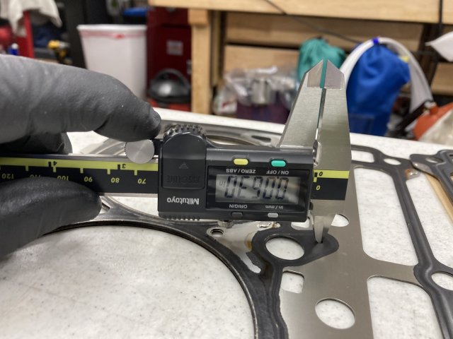

Just the head gaskets, that’s the advertised RE improvement of 33% more oiling to the valve train assembly, the only change was orfice size was increased in the head gasket. Aftermarket head gaskets like the Cometic MLX gaskets still use the smaller orfice size, you have to drill them out if you want more oil up top. It’s why I think some builders have lifter and oiling issues up top because no one notice's this.

I thought there was only one part number for the factory head gaskets. What is the redeye part numbers?
8,812
7,725
That looks like a huge difference!
Factory head gasket are all the RE design now, but every aftermarket one I’ve seen still uses the smaller orifice hole size of the original design
