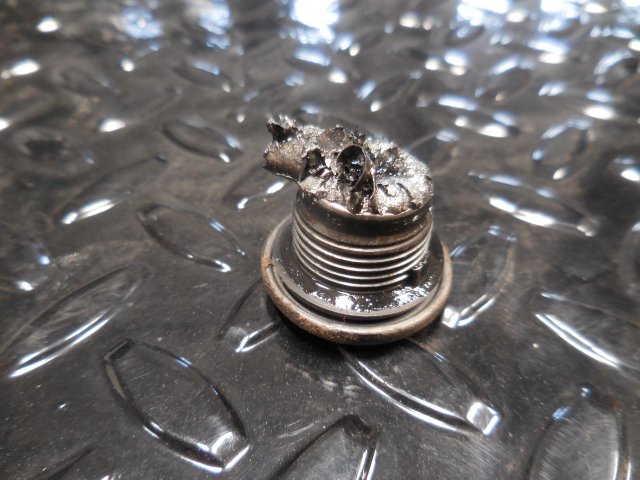

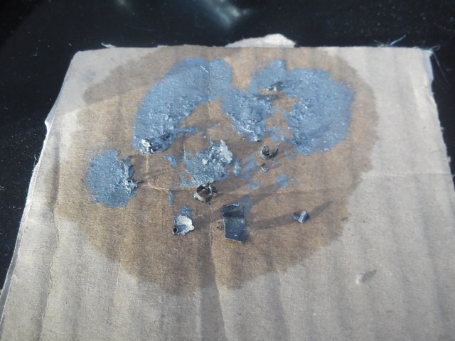

People sometimes give me crap for not driving a new (or new to me) vehicle until I've checked all fluid levels and that all fasteners are tight, or at least present. I pick the vehicle up, then it goes directly from the trailer to the lift.
As I'm checking, magnetic level plugs go into everything that doesn't already have them. Then the engine and diffs get new oil at about 500 miles to get rid of the break-in crap.
In the past six or so years, the only vehicle that had all correct fluid levels was the Durango I recently bought. Well, except for the engine, which had a bit too much.
I'd put new fluid in your diff, then change it again after a few hundred miles. After that, keep checking the magnetic plug.
Hopefully you'll see less debris on it after another 2,000 miles or so.

Jeeze Jimmie...where do find the time to do all that....ooops I forgot...ya got no humanity to talk to within 1500 miles...
Believe it or not, but it takes a lot less time to check and fill up fluids as needed than to deal with the potential consequences. Plus, I hate noisy gear sets.
Not that setting up new gears is rocket science, but it's not all that fun either. Still kicking myself for not changing the fluid in this one at 500 miles as usual, but letting it go to a bit over 1,200. A few fluid changes and multiple cleansings of the magnetic plug later, it's thankfully still alive, if not as well as it could've been. DSCN0843.JPG
