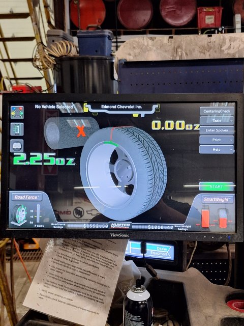

Ordered 2 radials for drag week. One mounts up and calls for 2.75oz.
2nd calls for 11.5? Flip 180 and calls for 10. Summit does a next day air exchange. It arrives yesterday at lunch.

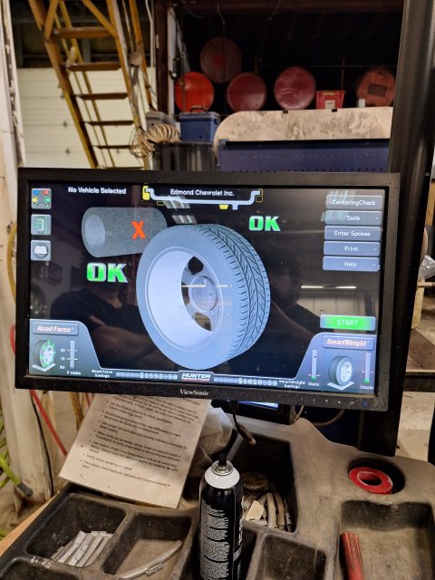

Replacement tire calls for 11.5...are you fistf&@king me? Break it down and do the wheel only. 1oz direct opposite the stem and laser says she's good.
Mount it back up 180...15.5oz...

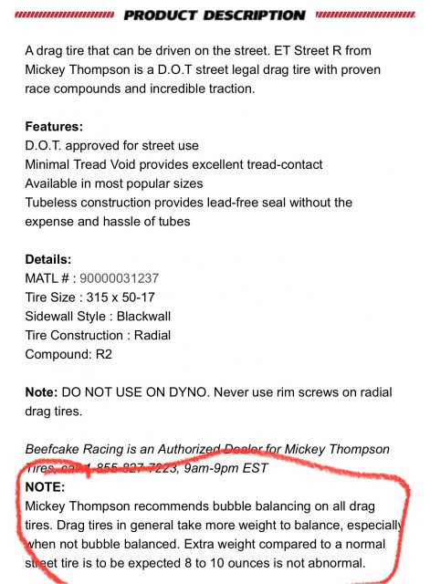

mickeys site says that much weigh is normal and acceptable. Use a balancing beads inside of the tires, lots of people do. No other options for a street legal safe drag radial. Do you have beadlocks? I trimmed the inside of my tires for mounting on beadlocks and they still take weight but much less to balance
That much weight isn't even normal on a tri-axle dump so forget 15oz on a drag car.
Per MT they will warranty a tire with more than 1% of the tire weight in ounces for balance on a radial tire. For a 35lb tire that is 5.6oz of weight. Industry standard is 2% so right at 11oz for anyone else. So yes. 15oz is absolutely Bonkers. Bias ply and straight race tires are different. The sticker on the tire Indicated as much. But it's not bias and it's not a non-DOT tire.

Verdict is in. MT's QC group led by Ray Charles can eat a fat stack.
This is one of the radials that just came off this set of wheels. Believe about 3/32 left from the 5/32 new and the old set balanced out around 4.5 and 6 total ounces last time. I wonder what changed...but this 100% confirms both tires were trash. Can't wait to see the 3rd.
