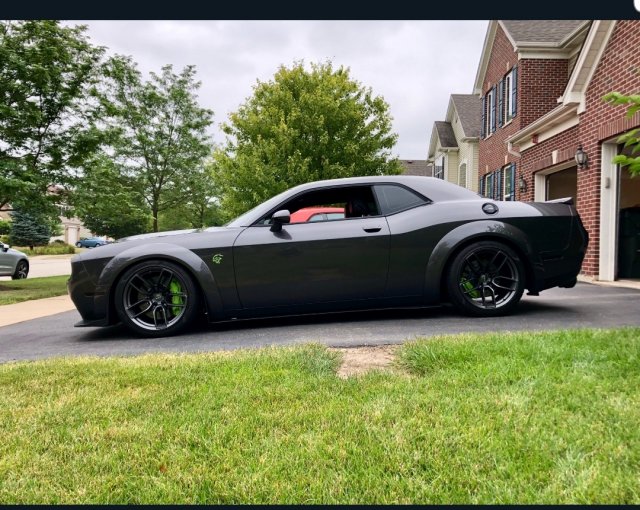

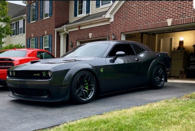

So I just had the dealer, which was a mistake, install the blue Mopar lowering springs on my 2018 WB and boy it sure didn’t lower it much at all. No I know they will settle a bit but it was 1/2 inch up front and just under 1/2 inch in the rear. Not impressed. The car does ride a little stiffer and more planted which I do like but I was really hoping for a full inch in the rear. Live and learn. The stealer charged me, I’m almost embarrassed to say this, $842 for the install. I almost choked when they handed me my bill. I was figuring it would be around $500. Here’s some before and after a.

Great color!!!! Live and learn...

I think it looks great. Lowered mine a fuzz over an inch and with over 30K miles on the KW adjustable springs, both CV boots have failed. You might get luckier by not having altered the half shaft angle as much.

I never even considered that! If it makes the car handle a tad better I’ll be ok with it.

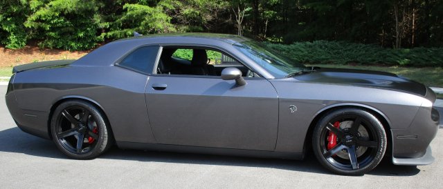

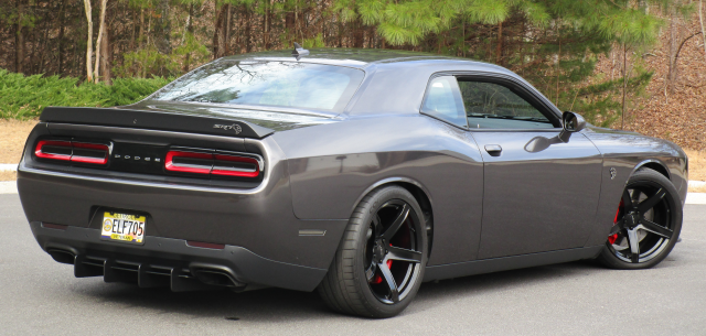

Should have had Jim do them lol. Would have cost you half that beer and a pizza! I did H&R and couldn't be happier. I will admit they might not have dropped much but any drop is better then that awful gap! Screenshot_20190813-201959_Gallery.jpg Screenshot_20190811-193023_Messages.jpg
