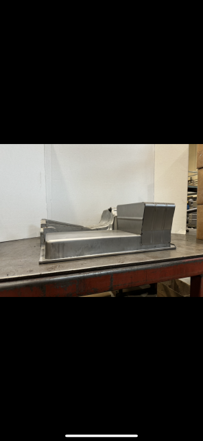

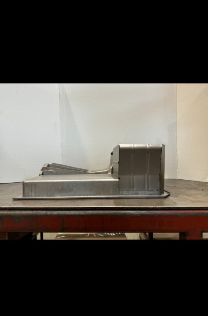

It does, but not much, front sump is wider. Here are a couple pictures during the build process compared to the stock pan. IMG_9019.jpeg IMG_9018.png

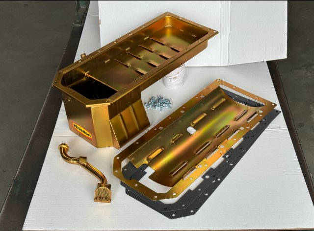

Received the first 10 pan kits from Milodon for the 6.2 Hemi’s. I am waiting on the shipping boxes to arrive next week and these will be ready to ship out, 5 of these kits are already spoken for. IMG_9228.jpeg

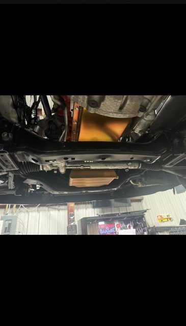

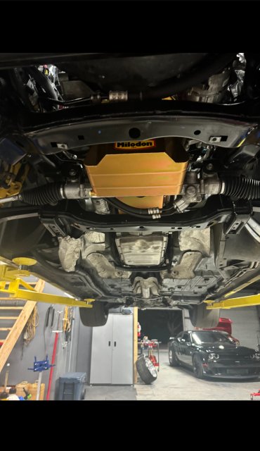

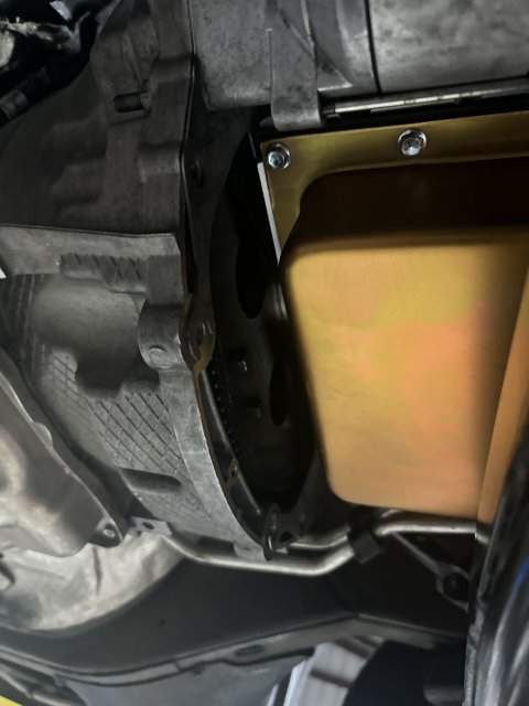

IMG_9264.jpeg IMG_9263.jpeg 73440420600__9BD77B0D-9FBE-4F23-95BD-9447328BAAD0.jpeg

Looks great. If these hold 7 QTs I wonder how much the stock pan holds
7,726
6,534
But weary about not spreading out the transmission load on the oil pan bolts

@Unholy707 they hold 7qts plus the filter.
I have looked at building some braces out of steel tubing, one brace for each side that connects the pan rail to the bell housing. As soon as I can get some free time I will fab a set up.
